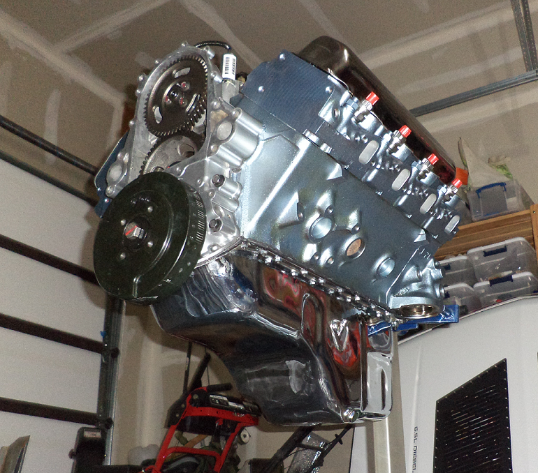

Spring 2013. New "ULSD" IP, rebuilt motor, High Output injectors, Air Dog DF-165 pump (15 PSI which, IMHO and Stan's. opinion, is too much).

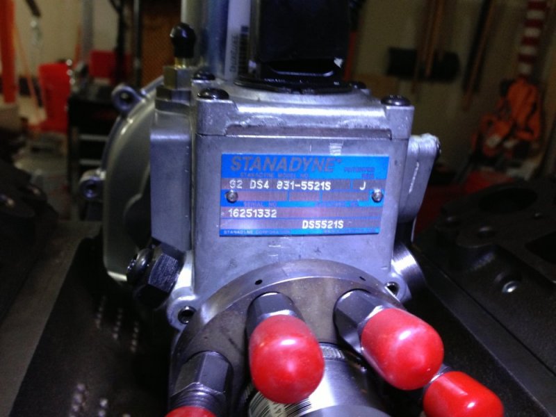

No I didn't use a fuel additive, 2 stroke additive or otherwise for way to long as I was stupid thinking ULSD pumps don't need it....
Truck still drives ok and accelerates great once it's warmed up but doesn't feel right really. That and coal is too easy to roll so I'm watching out the rear view mirror almost as much as the windshield when accelerating. Rattle and chatter noise never goes away and is so annoying that the truck is a pretty much a hanger queen.
Bill and I have tried repeatedly to get this pig sorted out and have condemned the IP. New tunes that 'work great for everybody else' run stupid and worse than my current tune (grey smoke never goes away and/or it won't accelerate).

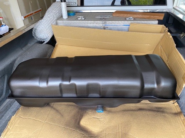

Rubberized undercoating on the tank is done. Painted it too because I've got too many old rattle cans that need to be used up. Not a 'coat of many colors though...just two.
I've drained 15 gal. from the almost full tank. Drove it 80 miles and now I'll just drain the rest using the LP. Metrum fuel sender says the tank is empty which means there could be anywhere from 5 to 10 gal. still in there.
New Tank, LP, and then get it started. Then the IP later this week and, again, start it. Then the Injectors. Figure I'll eliminate the non-start issues as I go along.
