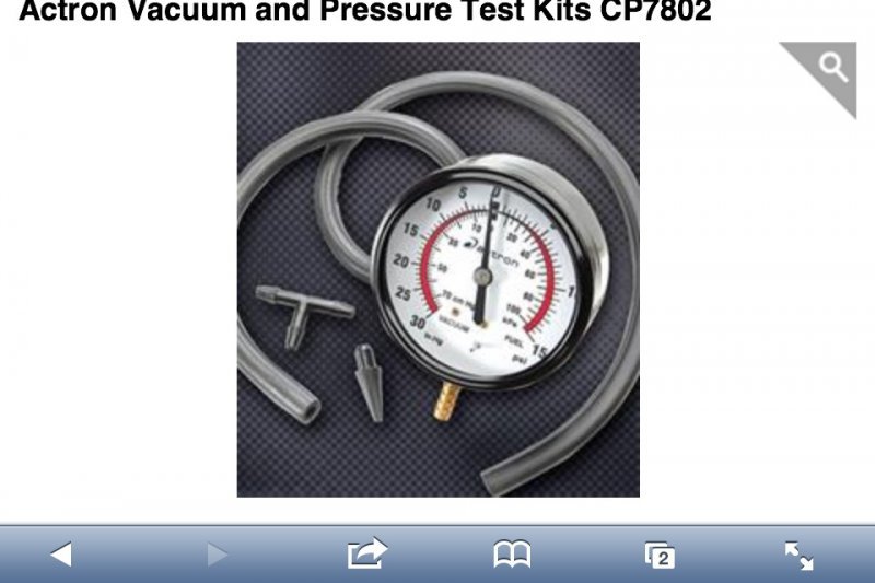

http://m.summitracing.com/parts/anm-cp7802?seid=srese1&gclid=CPii5ebVnMQCFciTfgodqQYA4A
$15 so worth it. Tee in before the ip. Tells you when lp is working, restriction from fuel filter or tank. Etc. when the lp is not working your ip will draw through lp, wearing it out quicker, less power, less mpg, no more guessing.
