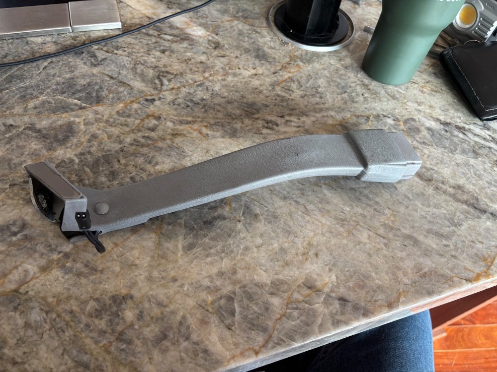

The DS seat belt receiver was having issues. Selt belt buckle would snap in, but the light on the dash would go on and off at will. So I picked up a used one from a ‘99 Suburban in the Pick Your Part boneyard for $17. This will get installed when we are back up in Montana next weekend.
