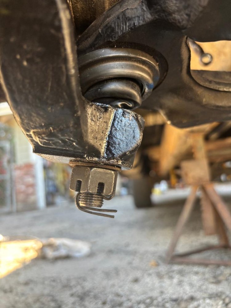

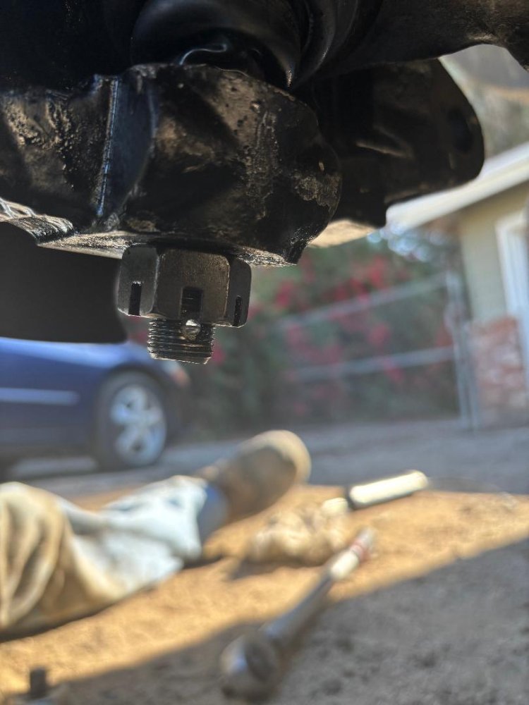

FWIW I installed the Moog ball joints on the ‘99 and they had close to 70K miles on them. They moved freely in the socket, but there was no play from wear. I reworked a pair of forged LCAs which got the Energy Suspension Polyurethane bushings and new Moog ball joints. While I was in there, I ordered up new Moog upper ball joints.
The bushings on the upper control arms were fine with no play. I need to to pick up another set of uppers from salvage and install the Energy Suspension poly bushings I have from two separate kits. Never really understood the whole reuse the steel bushing shell process.
Got the passenger side steering knuckle reamed. Still needed a washer under the castle but to keep the cotter pin within the castle nut. Last time I needed two washers, but the ball joints were never the problem. It was the tie rod hole that I overdid the ream depth, something that I avoided this time.
