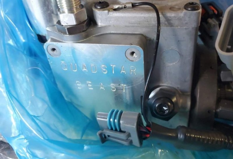

I have an injection pump to do as well. Going for a bit of an upgrade though...
