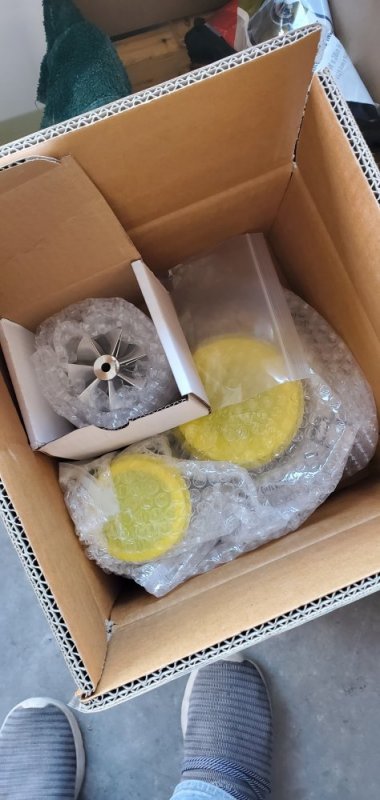

More parts... this box is full of a bunch of fun, 63 mm compressor wheel and front exit housing for the HE351VE. In a heavy box under that is the Quadstar torque converter. In a bigger box next to those is a Champion aluminum 3 row radiator. Now to find the time for all this seriousness...
