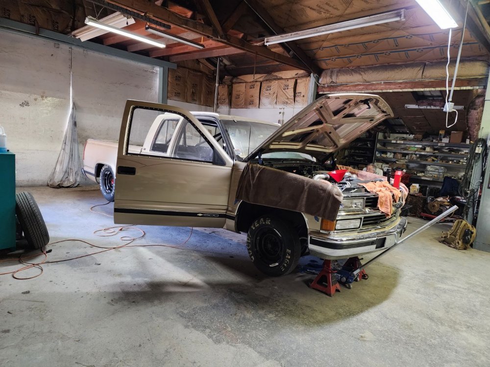

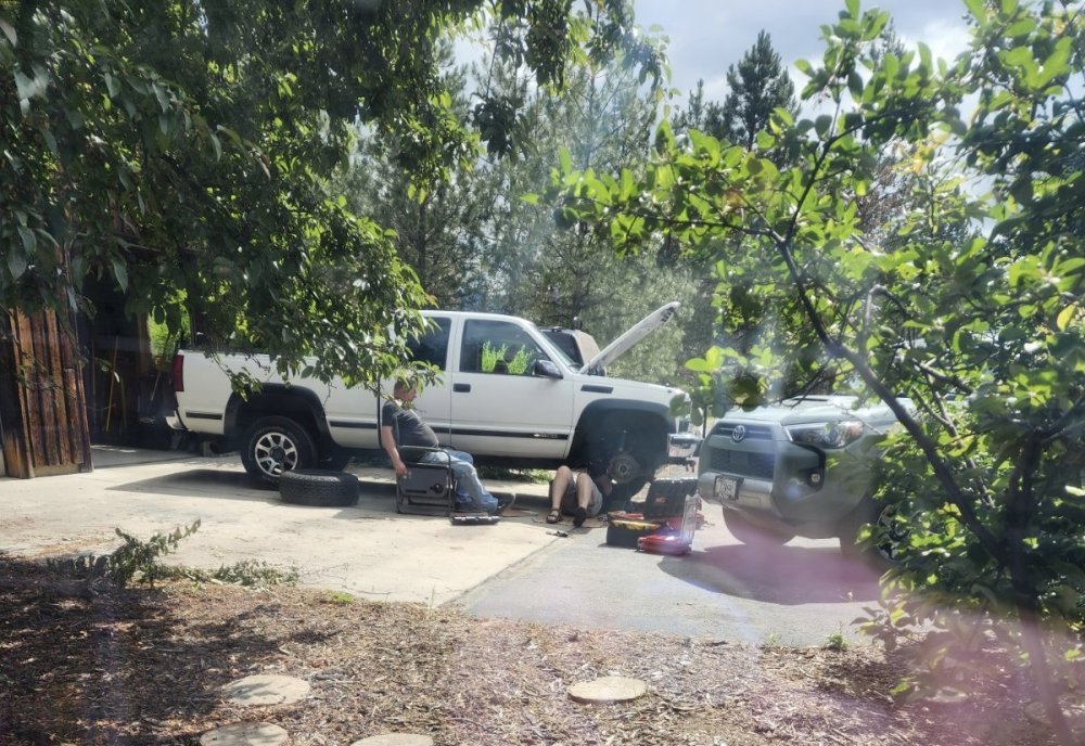

We threw in the towel and towed it the mile to my local mechanic who loves electrical work.Also might verify the purple wire is on the correct terminal

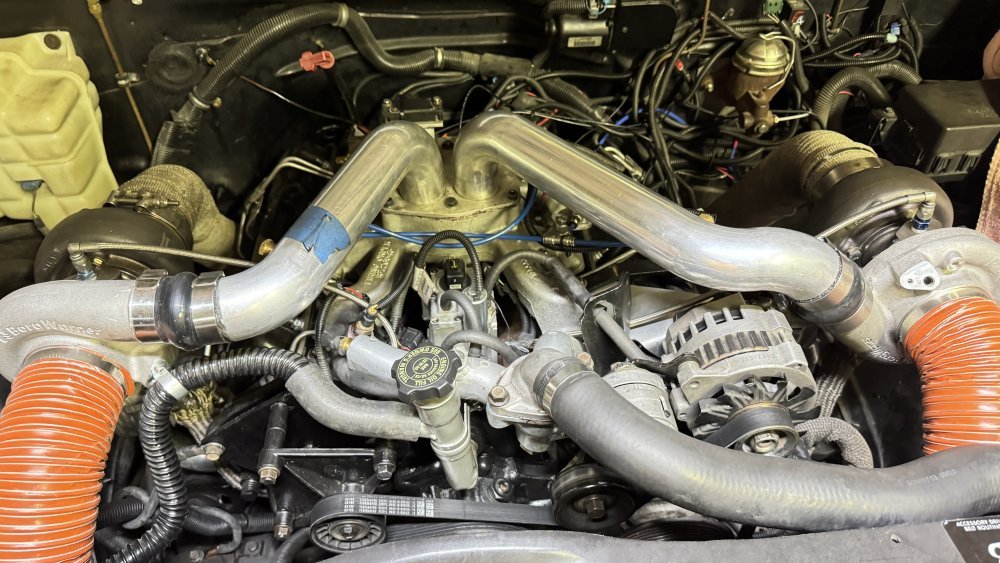

It was fun to finally get Paveltolz and his wife to our Montana home. I know he was stressing over his truck, but I also know the beautiful surroundings had a calming effect. My local mechanic is very good and reasonable. I hope to have Paveltolz back up in August to help with the new Optimizer installation.Thanks to everyone who’ve offered their assistance in sorting out the starter issue. . Mechanic sorted it all out in no time and I’m smacking my head repeatedly…. Yes, it was the exciter wire but it wasn’t…I put the exciter wire on the incorrect stud. Oh well, this is why we don't have nice things. On the road in about a half an hour to go see Bill. Confidences is restored.
Big thanks to BigT for support, lodging, meals, transport and adult supervision.
Certainly can’t beat the views here either.
That’s what all three of us believe.
I noticed that when I pulled mine off the ‘99.Ya know, the powermaster 9052 only has the big cable and the small terminal- nothing extra. Just saying…

You called it Brother. I’m sorry I missed your post. But, we’d already towed it to Wayne’s (the mechanic).Also might verify the purple wire is on the correct terminal
Had to have been a bad starter because the exciter wire was correctly attached to it.
