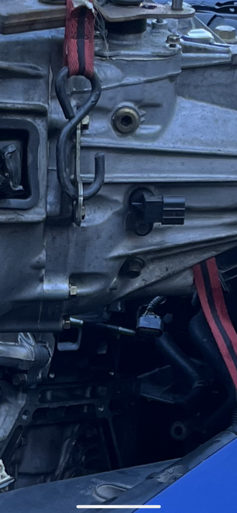

I would call the trans shop and mention this / show them the pictures. the missing bolt in the second pic I wonder if not a bolt but some kind of adjustment rod like on some auto trans where an adjustment rod / threaded stud with lock nut on the exterior of the case.
I bet that lower bolt is a locking bolt for something in the front area of the trans. doesn't "bolt" anything down, but locks something internally from moving, sliding or rotating. not unless it's a case drain plug. hard to tell exactly it's position in the case from the photo.
Yeah there is another drain. I wonder if this can be installed and lock down the part now that it is in the vehicle?
