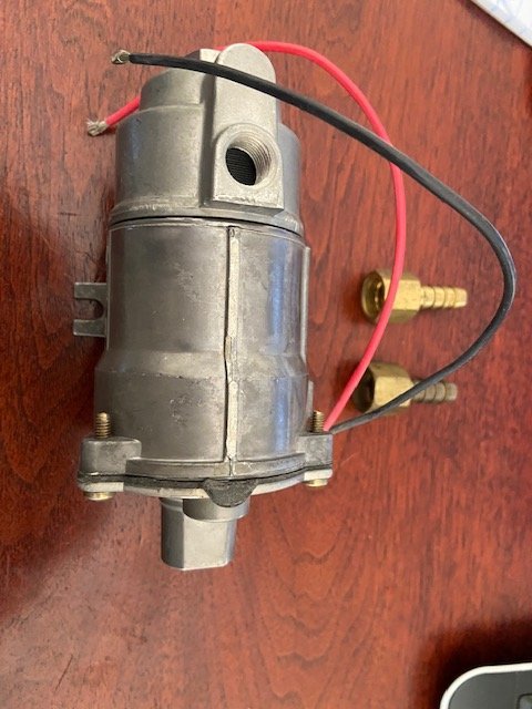

Have this original Walbro FRC 10 purchased from Leroy. Also have the filter. Looking to install this on the ‘94 Suburban that it was intended for. Hoping this solves the non-flow of fuel through the IP.
Pic is of the pump and the fittings. Obviously those fittings are for the fuel hose and need another fitting into the pump. What do I need?
Do I drill through the frame to Mount this thing?
Also does the fuel filter install before or after the pump?

What thread is the holes into the pump ? Pipe thread ?
Dont know what thread the hose adapter fittings are too.
Probably be easier to go to a parts store with the pump and get fittings that would go direct to hose, rather than try to nipple those fittings to the pump.

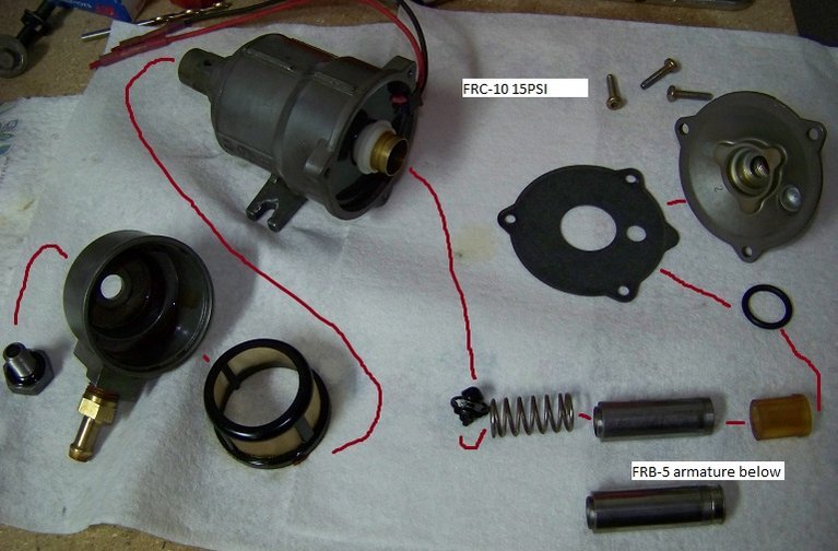

@Will L. The lift pump has a screen in it. I have plugged it with bug goo many times. See pic.
@Big T I just recalled: Those fittings go on the factory lines to convert to hose. See the fitting I have on the lift pump below.

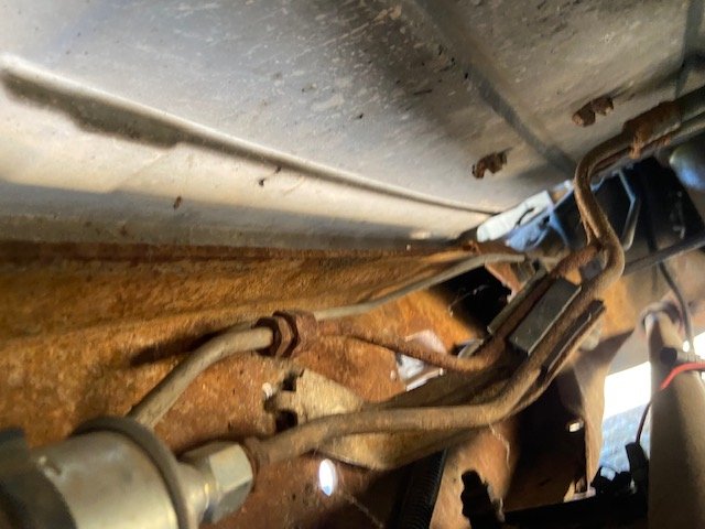

I got two (2) 90-degree barbed fittings that thread into to the Walbro at NAPA. Question becomes what to do with the hard fuel pipes/lines going into the OEM pump? Do I cut them and put hose on them?

Yes the fittings are to connect your 3/8” sae30r9 hose without cutting and modifying the metal line.

To clarify: do not remove the bowl screen because without a tank sock, well, that's why I posted that picture. The bugs kept clogging the screen so I removed it and ruined the pumps. I got a new armature for the FRB 5 but couldn't get one for the FRC 10.

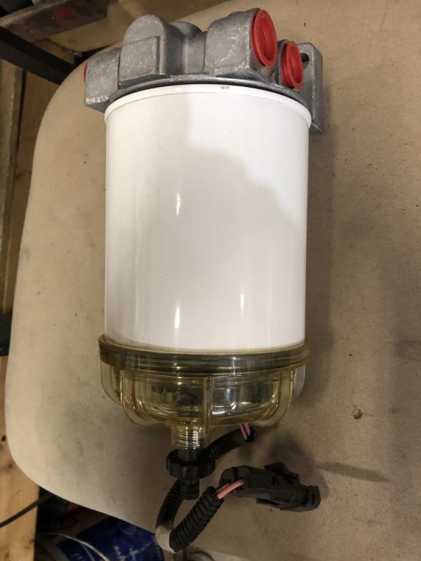

So my water separator, should it go before the lift pump so that the fuel and water is sucked through it instead of pushed through it?
Im about to be putting a Cat filter and a Cat water separator on my truck. And at the same time drop the tank, remove the sock and install Leroy’s metrum rod that I got from Warwagon..

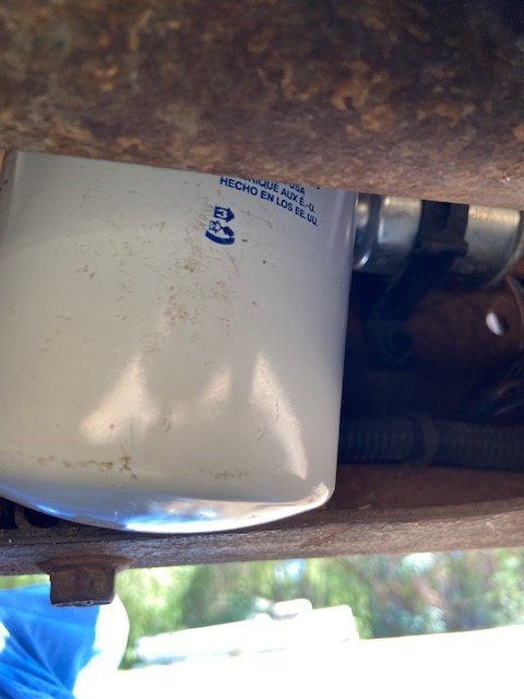

Was checking on mounting location for the pump and the pre-filter. I think the Walbro can be vertically mounted inside the frame rail. Hard line from the Walbro can be disconnected from a bracket and moved forward to create room.
Hard line from the tank to the pre-filter really can’t be moved and there is not much room there between the frame and the torsion bar.
What have people done in the past?

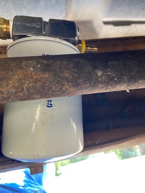

I too have a filter that appears similar in size. This ine has a heater and water trap.
I would like to mount it pre lift pump but dont know how the suction would affect the operation of the filter.
One other thing is, i just cant seem to find a suitable place to install this filter where it would not hang below the frame rail.
Maybe in a corner of the truck box and install a compartment with a cover over it.
Then I’d have a clean place to store the fuel additives too.
You only need a screen before the lift pump. They, esp electric, do not suck well so the water separator goes in after the lift pump.
My buddy has a 1979 Little Red Express that the PO put the filter in before the mechanical pump. Pulled the service manual as we couldn't even hand prime the pump at times. Put filter after mechanical fuel pump and no problems.
I am now confused. Will L. said install filter before the lift pump and now you are saying after the lift pump? So which is it? Please settle this boys as I'm planning to mount these soon.
