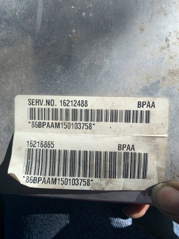

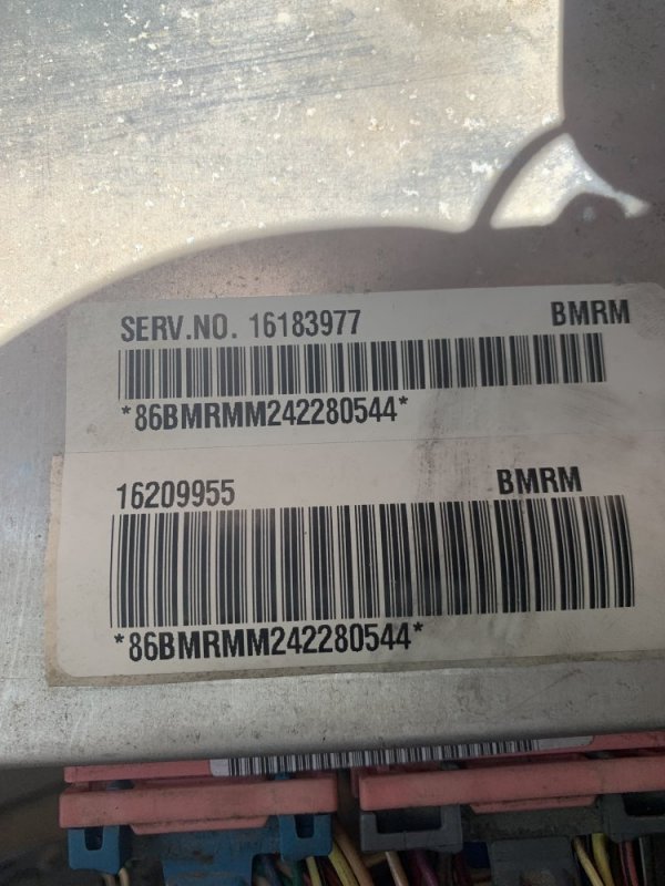

Is there anything I need to worry about running this 94 pcm vs my original 95 pcm? Here’s a photo of the numbers on each. The 95 has the BPAA prom code which I just plugged into the 94 pcm and hooked it up. 32D620CD-9E99-415A-AE8C-E138305A8232.jpeg375D327D-3AA7-4420-8333-BF49D42847A1.jpeg
