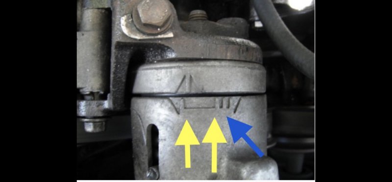

Just install belt and look at tensioner indicator.
The rectangle (between yellow arrows) is good. The lines by the blue arrow indicates belt is stretching too much and needs replaced asap. Too tar the other side would be too tight.
Where the marker is in the picture is EXACTLY perfect new belt.
@Will L. ya know what's crazy? on my truck, I can take the belt off and when re-installing it the marks are sitting right were you pic shows until I start it up. even with a new belt it does the same thing where as soon as it cranks up the indicator moves to the warning mark and stays there!
Over time the belt stretches. Eventually the spring in the tensioner gives and wont pull it as tight even with stretching belt it will “read” ok. Then the belt starts squealing. People chase a hundred things- eventually they guess enough parts and get it figured. Some only replace the pulley of the tensioner and think they ruled out that as a problem.
