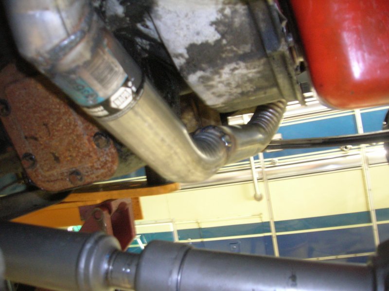

Me? Banks never did a van, no room for one unless you go factory center mount, make your own center mount or do what I did. Factory vans put the turbo at the back and feed it from each bank, then the exhaust exits out of the turbo so no crossover is needed. When Banks built his kits, the GM centermount setup was a twinkle in someone's eyes, :p
Very aware of the 6.5 and Duramax in the van , work on them every day . Read a couple posts elsewhere about a Banks in a van . The point is that a crossover might not be that easy to make depending on the owners fabrication skills . Factor in the hassle of getting the truck to a muffler shop and paying for some custom work that adds to the overall cost of a good deal .
