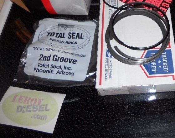

I am working on my 6.5 build and stumbled onto this thread. I am considering gapless rings, but doesnt look like Leroy sells them anymore and couldnt find them on Total Seals website eaither. So you can have standard stock rings machined into gapless rings?
