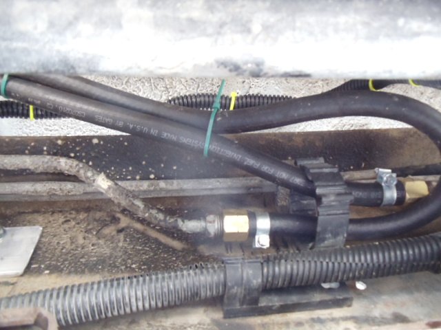

The rubber lines that connect to the sender are permanently crimped to hard lines that get anchored to the frame. Currently you can get an SKB feeder on RockAuto for $56. Return line, I got a GM version off Amazon for like $106, whereas RockAuto was more and then they gouge you for shipping.just an FYI on replacing the fuel pickup tube / sender in the tank. all of the aftermarket ones out there will work (application specific) but your fuel gauge will bounce around when on the road due to the fuel sloshing in the tank! I experienced this when I replaced mine. used the Spectre brand from RockAuto. there is an alternative that iirc Leroy Diesel sells called the metrum rod sender. it's a bit more pricy than the factory replacement.

take a good look at the rubber lines that connect to the sender assy too and replace all the O-rings.
