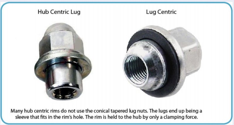

I don’t understand why hub centric. My understanding is I get that IF the lugnut allows shifting, the. The hub is right close to hold the vertical load. But on wheels and lugnuts that aren’t truly holding all the weight with the hub and the nuts only hold the horizontal load shift- why bother?
If there is 5 thousandths clearance between the hub and the rim- it isn’t really holding the load- the lugnuts are. Now if you do like ford did for a while and have interference fit of rim hole to hub, and there is a gap that allows play in vertical wheel stud to rim gap- then yes the weight is on the hub, not the wheel studs. But with acorn lugnuts- they automatically take all the load as they become the interference fit.

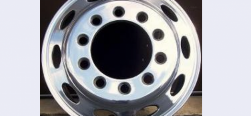

I found pics showing taperd (acorn style) and hub centric rims in 10 hole bud for semi truck easier online. The lugnuts are for regular vehicles. If you are switching to hub centric- buy hub centric rims like for a ford, not a gm. 067EE4D5-B906-40BC-BD02-2EAC1EC7FC15.png52880A55-60C7-4B2B-8DF3-9FD052362410.png5D5B0EA2-08BB-4B71-94AA-09A57C22E784.jpeg
