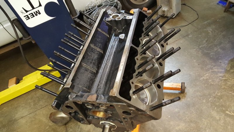

I had put together an optimizer from Ted's more than a few years ago. Maybe put 5k miles on it and then the drivers side head gasket failed. So I pulled it apart and O-ringed the deck and used Cometic MLS gaskets. Ran it for a few weeks and noticed compression getting into the cooling system, but not leaking coolant into the cylinders. Let is sit for a few years and this summer I decided it was time to get back into this money pit. I couldn't get the engine to turn over for anything. Pulled it all apart and wouldn't you know it, coolant made its way into a few of the cylinders and destroyed it. My plan was to go .020 over and new pistons. The bores would not clean up with .020, and the machine shop said that .030 wouldn't do it either.
It was time for a block hunt. After a bit of searching I decide to roll the dice on an import block. I had some issues with the company I bought this block from. The bores were .002 over max spec and I ended up boring this .020 over. That is another story that I will open in the 6.5 section. It has 18:1 pistons, gapless rings and a balanced rotating assembly. Heads studs and Fluidampr are on hand. That brings this story up to date.

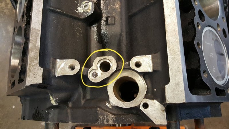

I have not used or seen a block for center mount turbo, yet it appears that these import blocks show up this way.
That brings up a couple questions.

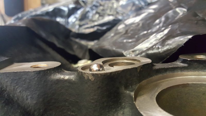

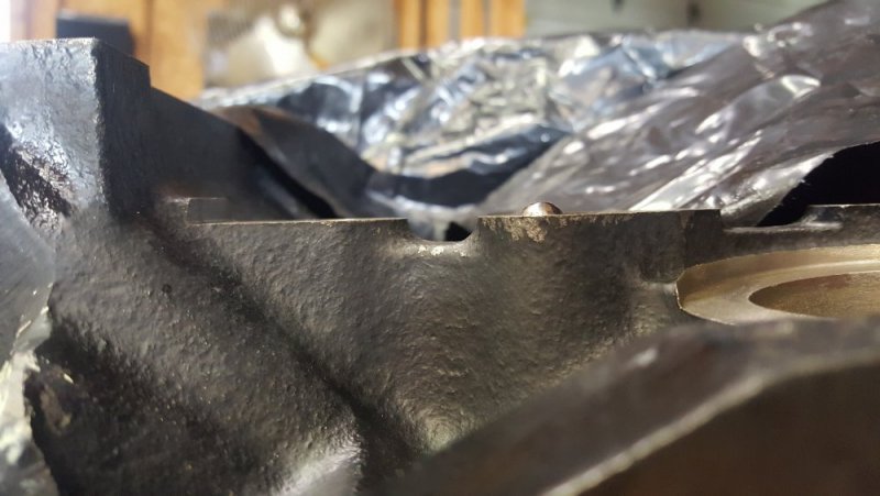

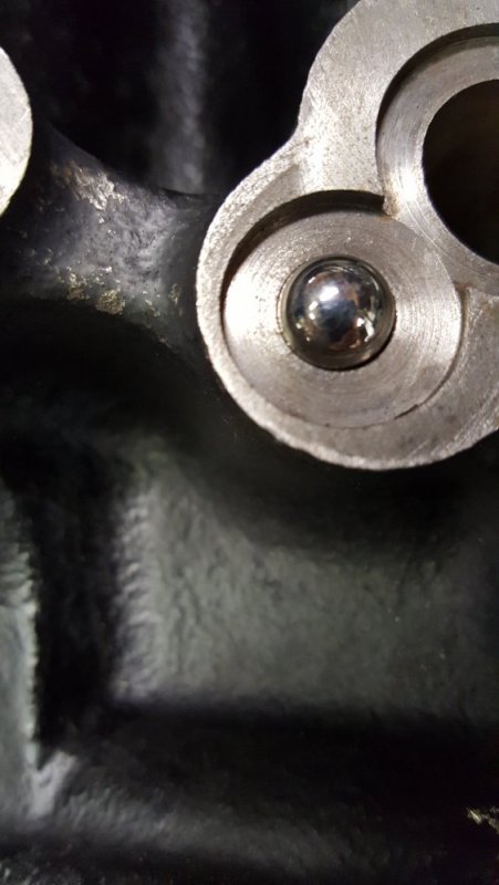

I had this block sent right to my machine shop. I didn't notice the ball bearing and I have not messed with it. Is it pressed in place as a location pin?
Is it a threaded hole and the clown shop I got it from hammered a bearing in there for some reason?
Has anyone plugged this oil return hole with something for use with a side mount turbo?
