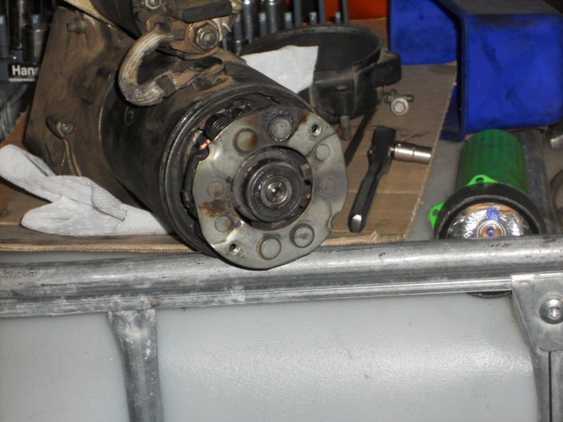

This starter had a bad ground connection on the top right of the brush plate - see the heat marks?

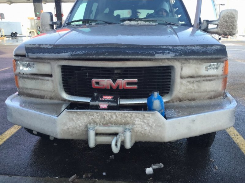

Colby and the '94 made it home safely. Everything performed flawlessly. This engine has 275K miles and slurps a quart of oil every 600 miles, but it runs well and keeps on going.
The HID headlights I gave and installed for his Birthday got rave reviews, but it wasn't hard to beat the old fogged over OEM headlights.
