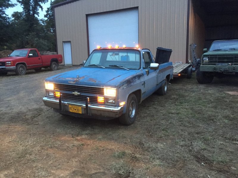

My 83 had a tree fall on the cap back before I bought it. All it did was bust the windshield and fold the roof in. It fell diagonal across the cab from the passenger front corner to the driver side rear corner. I took a bottle jack and pushed the roof back up and the windshield actually fit back in. It doesn't leak and the doors still shut good. It still has a huge dent in the top of the cab so what I'm wanting to know is if there is a way to remove the top of the roof without having to cut and weld. I want it to look factory again without 10 gallons of bondo or a new cab. I am by no means a body guy so this is why I don't want to cut and weld/

It doesn’t have any creases just a dent. I’ll post a picture of the truck. I don’t have a picture of it when the can was smashed but it was so bad you couldn’t sit on the passgener side. Guy I got it from bought it and had it hauled to his place. Drove it down the driveway and parked it by his house. Came out the next morning and I tree was on it. Sat for at least a year and the interior is still like new besides the carpet and I changed the dash pad and speakers. It’s hard to see a dent here but I’m at work and can’t get a picture DF333556-6AA5-42F7-AB94-61CC8C45D602.jpeg
