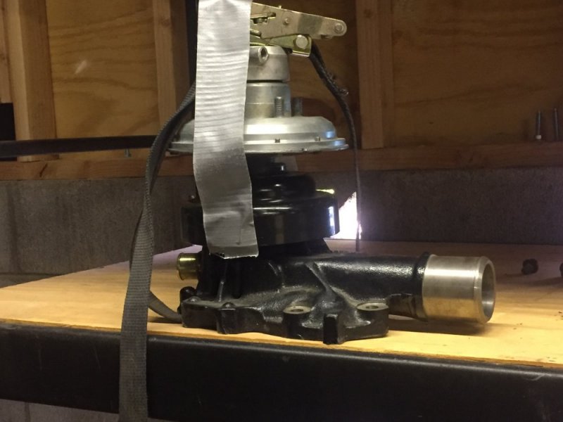

So what I'm looking for is the center shaft with the threaded end. I want to be able to put it in my lathe so I would like it to not be bent during disassembly. Obviously I would pay for shipping.
Thanks
i have the fan and pump. doesn't look like either part will come off without destroying the host.
as both parts are still good but not being used.
So it looks like from your pics the male thread is part of the pulley and the shaft is pressed into it.
I guess I need to amend this to say I'm looking for the shaft and pulley. Thanks for the heads up DJ. Don't really want to pay for shipping for the rest of the cast iron if I can avoid it.
