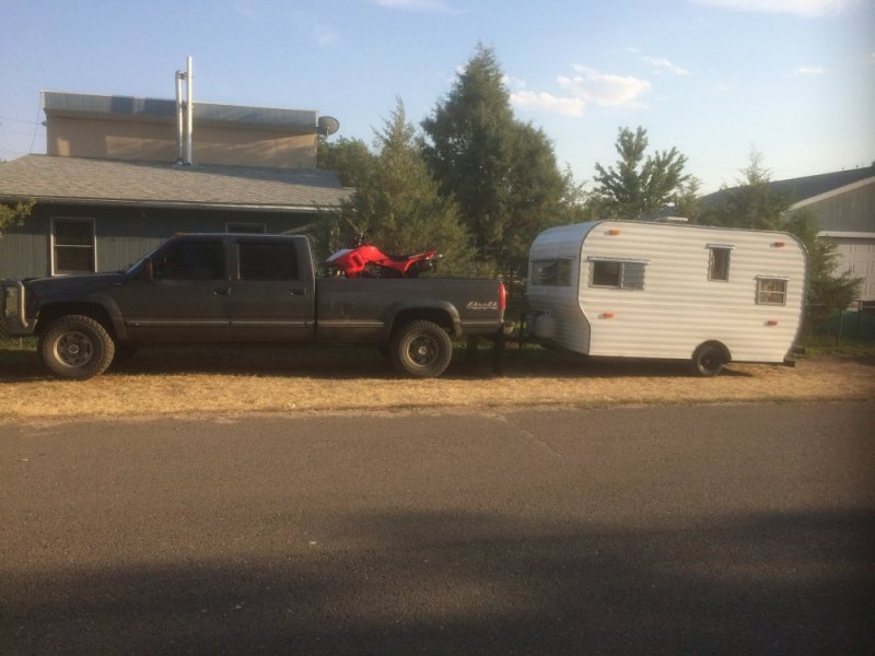

Yeah, the roofing and siding on my little camper looked great, other than it had dulled some and there was hail dents. After I got the roof and siding removed, it was more like swiss cheese. Plumb full of holes of varying sizes. I knew in an instant, that stuff was not getting used again. 😹😹😹
I’ll have to go to the garage and look at the receipt, see how much the roofing and siding was. It came out of Hemet California and I think shipping to Miles City was about 300 bucks, I didnt think that was too bad.
If anyone thinks they want to rebuild an old camper, always start on the outside and work Your way inwards, siding is the last thing installed. At least on these older units.
