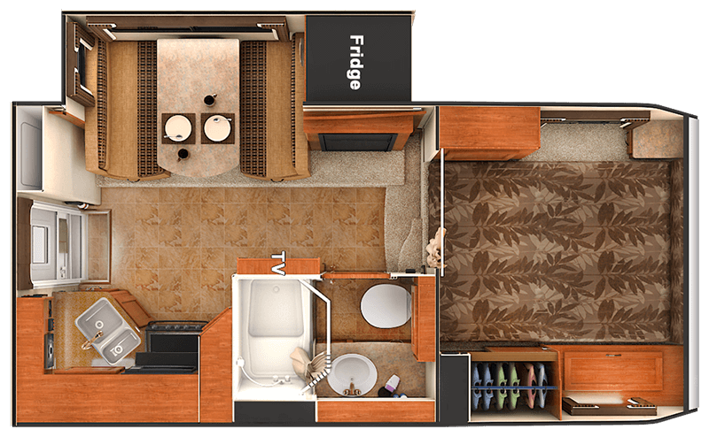

Came down to Arctic Fox 992 vs. Lance 975. Campers. No generator available on trailers unless ordered that way. (AF did have prep options with out the actual generator itself installed. Lance trailers did not.) Only reason to go with a trailer would have been a couch/chairs with foot rests to raise ones legs.
So looking at the AF the sales rep stopped by and said the Lance reps were there for the Grand Opening Day. (AF did not show up to the party - They should have...) Didn't know it was their Grand Opening. So the Lance rep came over and pointed out a few things they thought they did better. Then we went over to the Lance 975 and went over it in extreme detail - It's a new floor plan for 2016. Tips like store the bread in the microwave, close all the windows and doors and then open the one you want with the Fantastic fan running to get a breeze. This negated the noisy reversible fan the AF has over the bed by popping the Lance windows open and running the Fantastic fan over the living area. Further they noted the sewer vents were on the roof and a fan sucking air in on the roof could suck those odors in - RV code came into play on the Lance where they couldn't do it as the fan would be too close to the vents on theirs. The thermostat wasn't on the AC unit in the Lance. Radio was simpler in the Lance rather than a complicated fragile touch screen in the AF. (One button in the Lance to shut off the external speakers and never did figure it out on the AF.)
Fit and Finish on the AF was #2 to Lance. The bathroom door wouldn't close and the under dinette drawers had fit and finish issues. The Lance only had a wavy shower wall liner, the bed was easier to get into and dinette cushions were more comfortable, but smaller bathroom, and less kitchen cabinets, but, latching cabinet doors on them that will not pop open.
The AF has two 30# propane where the Lance only has two 20# propane tanks. Aka ~24 hours of generator on 20# propane. I will be bringing some extra tanks along.
I was prepared to see what they would do on the AF 992. The Lance is more expensive than the AF.

I got $10,100.00 discounted off the price of the Lance after breaking some arms. I suspect Lance was doing some dealer rebates and/or they sold enough to just want the volume over profit.
"What truck are you going to put this on?"
I point to Patch.
The look on the two Lance reps face, the salesman's face, and the Finance fellow face was PRICELESS! :confused::eek::wtf::facepalm:
Seriously it's going on the Dodge.
http://www.lancecamper.com/truck-campers/975/#overview
Congratulations! Glad to see that it has a rear awing (or at least available). With that 3 way fridge, time to upgrade the cables going to the bed. And stock-up on lube for the slide.
