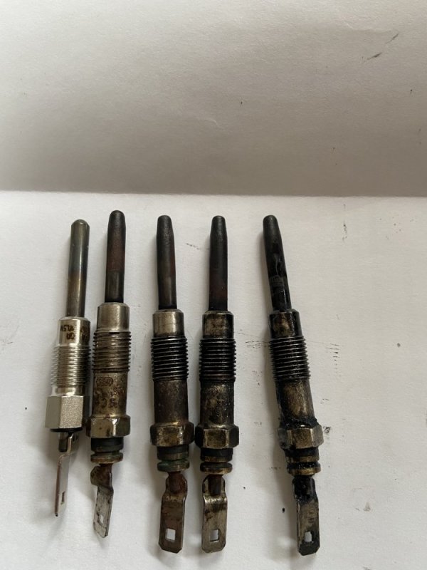

Right: old driver’s side Bosch glow plugs
Left: new AC Delco 60G
Is the taper on the Bosch by design, or is that wear?
I could used a new wiring harness. Is there a guy still making upgraded harnesses?
P.S. need to buy a set of deep sockets for Montana home to get the passenger side plugs out 😎
Take those old ones and bench test them. If good keep’em as backup and chuck if bad.
Notice the length and fitment of the 10mm hex for the socket. Delco for the win.
I also noticed some of the heat protectors shields don’t like the bosch for their added length.
