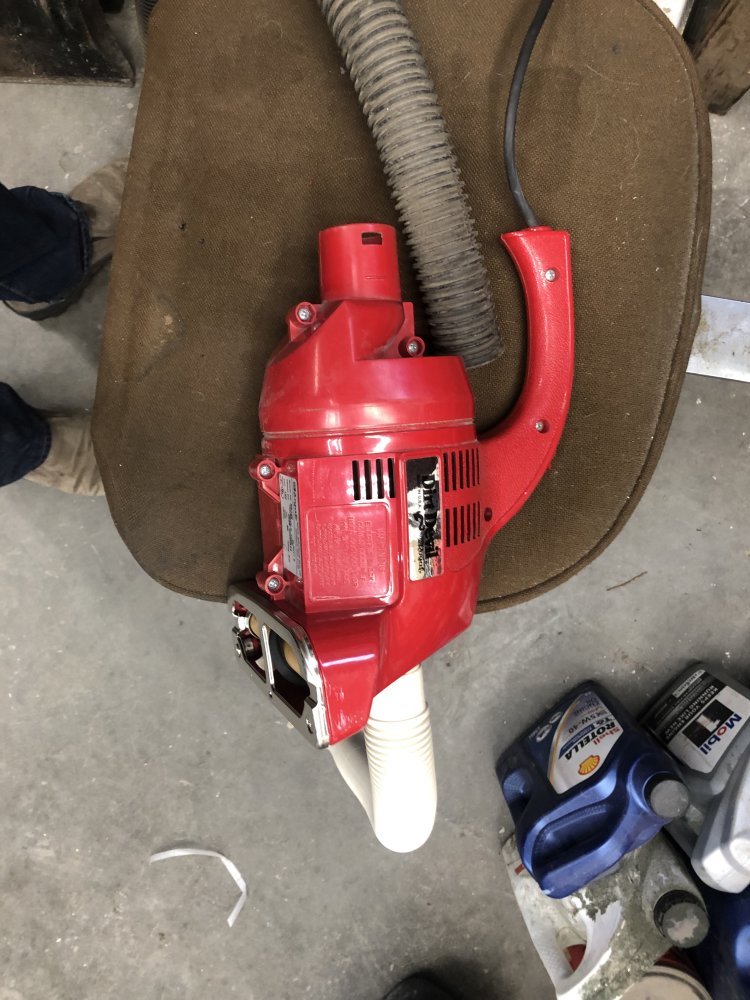

Amongst some stuff that was give to me is a 110 volt Dirt Devil vacuum cleaner. It has a suction hose that can be connected to the vacuum end. With the bag removed there is a tube that air blows out through. I believe that this little vacuum cleaner will make Me a smoke machine. I have some rough ideas how it will go together and I’ll be advertising to the various fakebook groups to try and find some smoke bombs. Fourth of July kinds I think will work great. Rig up a coffee can inside a five gallon bucket with a little sand in the bottom. Use a pour spout bucket lid and attach the suction hose to that, another small vacuum cleaner hose out the back and attached to the CDR port on the rocker cover.

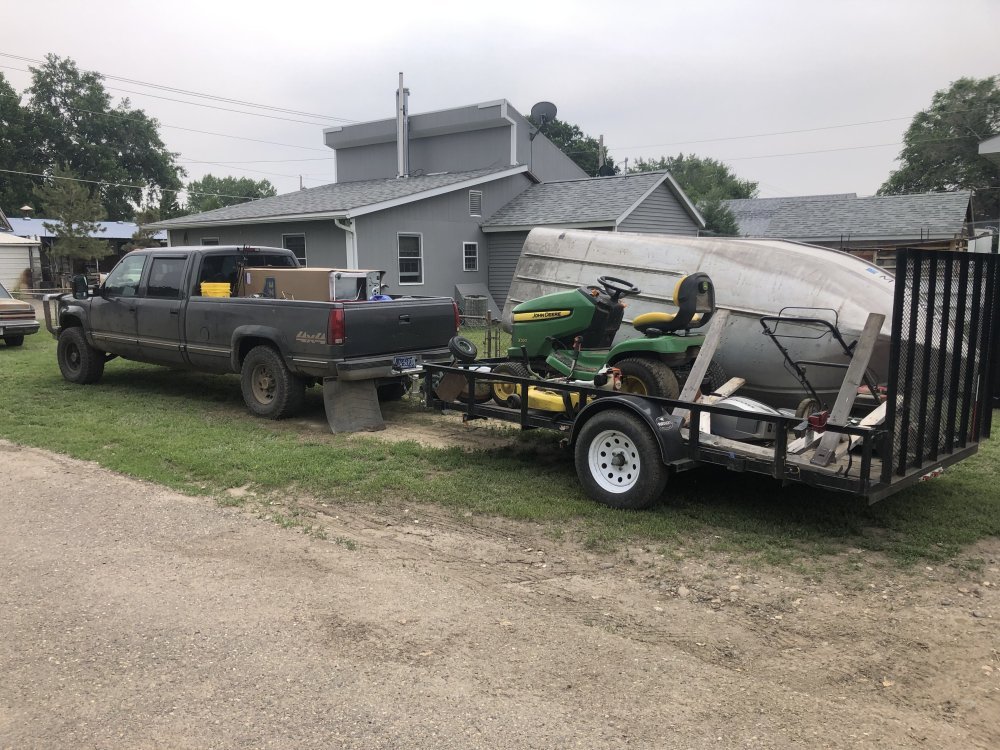

Headed to the cabin last Friday. About 18 miles out a big cloud of smoke from under the truck. I pulled over immediately. Looked it all over. See drips from under the truck but cant tell where it is coming from. Called triple A. They no longer respond. I was pulling a utility trailer. My son behind pulling the lake boat. He goes back to town and drops the lake boat. Comes back out and hitches to the utility trailer, I spin around on the interstate and head back to town, hoping the leak aint so bad that it catches afire.
Back to town I drop the bottom covers and fire it up. Just cant see good enough to tell where the leaks is at.
The son gets there and I borrow the step sons 6.2 gasser GMC and rehitch to the trailer and we then go to the cabin.

Idk about making a smoke machine from a vacuum- sounds like it could work. YouTube is full of videos showing how to make one from a cheap old paint gun or 1 gallon paint can, a glow plug and scrap parts. I too need to make one, the 01 tacoma has yonder code about emissions leak but I snaked it by smog this year. Next year I will have to have it right, maybe sooner. Every time I fuel up (open gas cap) when it starts first time it dies, hard restart, then drives ok. I hate fixing emissions stuff.
The Dirty Devil Vacuum Cleaner. Soon to be smoke machine.
I run a add in fakebook, local market place, for some smoke bombs, not the good ones, just them left over from fourth of July. Also in the add that if it was colored smoke that could be a bonus for what I’m needing them for.
I think a 5 gallon pail with some dirt or sand in the bottom. A steel/tin coffee can with the smoke bombs going off within it, the bucket lid with the pour spout for the vacuum hose and possibly might have to drill a couple holes in the bucket to get enough ventilation for the SBs to burn and also so that there would be some air movement so the smoke could get sucked out.
The black hose is the same diameter as the tube from the DD. Gorilla tape setting here to rescue that mission. Black hose to the CDR grommet and should have a functioning smoke muscheeen. 🤷‍♂️ 😹😹😹

Got home and scooped some gravel from the alley into the plastic 5 gallon bucket. Set the tin can in there with the small round SB contained within and lit the fuse. Popped the cover over the 5 gallon bucket with the vac hose within the pour spout.
All the smoke was sucked from the bucket and blew out the outlet tube.
I think this just might work, and, hope that the little vacuum has enough pressure to blow smoke out of the leak.
Planning on warming the engine real good before experimenting with the smoke machine.
Tried out the smoke machine. It most likely did pump some smoke into the enjun, but, as I suspected, I dont believe that the DD puts out enough pressure to push smoke out of the joints where the oil is coming from.
