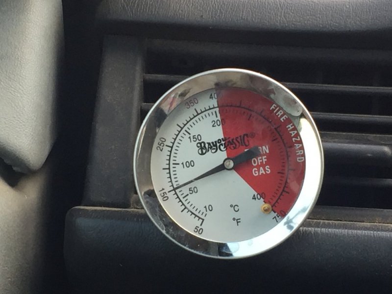

So it's working. Only gets around 50ish in the vents, unless I help out the condensor with a gallon of water, then near instant 38* at the vent. Definitely undersized condenser becasue of the r12 vs 134a.
How much does a/c in the 50's help? Left this in the vent after testing (cant find my normal thermometer - don't tell my wife I stole her's for a day). Here is what it was when I got in the car to go home today. 117 outside temp-
No, if I was there I would be freaking out- MY HEATER ONLY GETS TO 215*!!! Freezing over here!.
My wife would be happy as can be.
