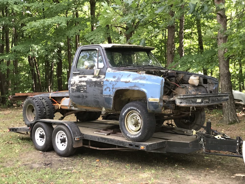

They say necessity is the mother of invention, so I will say that perceived necessity is the mother of my projects :) I was given a parts truck with a title a couple years ago. I didn't know what I was going to do with it at the time, but since it was free, I just couldn't pass it up. What I knew then is what I know about it as of this writing: It's a K30 frame of unknown year, with an '82 C10 cab on it that has factory AC and was originally a diesel. Unfortunately someone swapped the front Dana 60 out for an early 70s Dana 44 at some point, but the frame itself is solid, so it's a great foundation to a build.

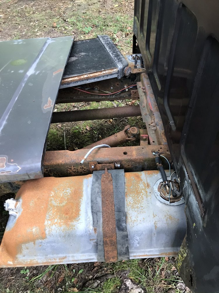

In the meantime, I have been slowly getting parts when I thought about it or they became available. Someone had taken the AC evaporator box off the firewall and cobbled a heater box in its place, so I got all of the AC parts off of a truck at the junkyard. I also got all of the AC accessories off of a squarebody diesel truck last year.

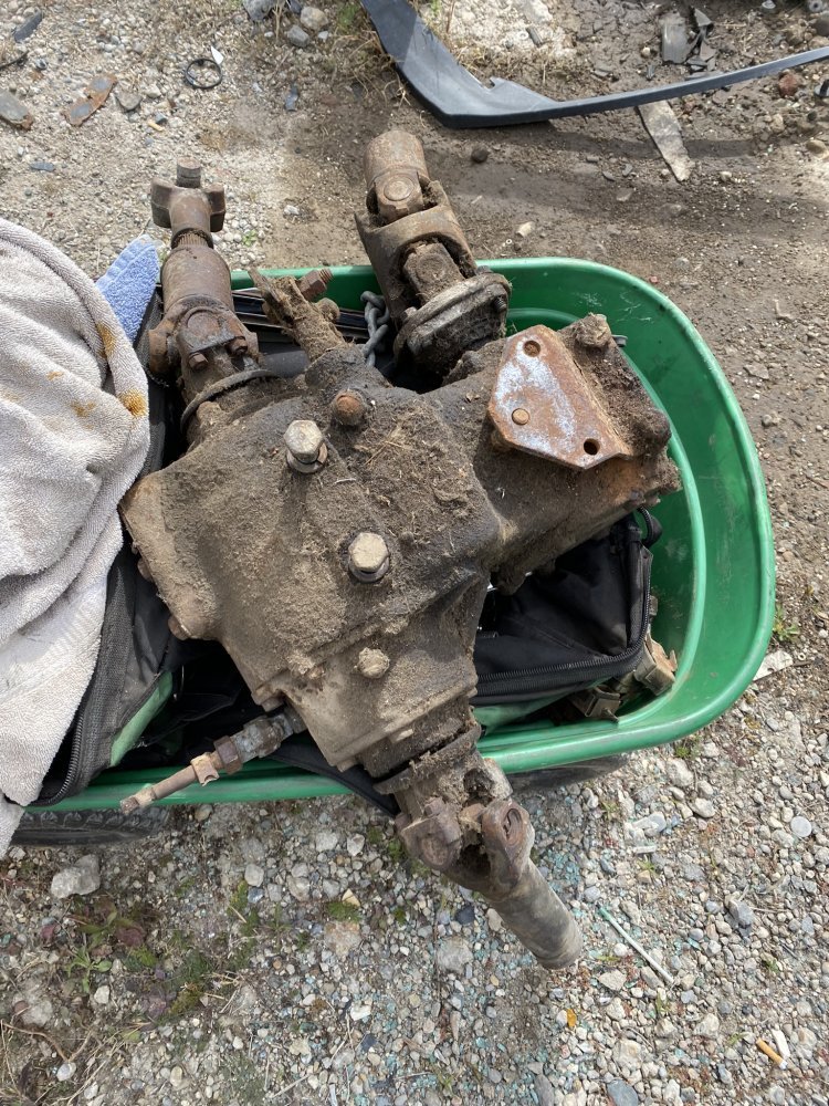

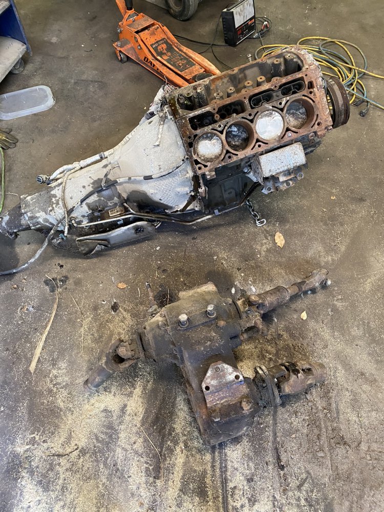

I've started collecting parts for this project. I found an old International truck at the junkyard that was 4wd. It had an NP202 transfer case under it, which I hadn't heard of before. I did a little research and found it's actually a heavier-duty (and heavier) case than an NP205. Conveniently this unit was divorced from the trans and had a passenger side drop, so it matched the factory GM arrangement. I want the truck to be close to factory from the firewall forward so I can make a tubular turbo system that will clear AC - you can't fit the factory cast iron manifold around the squarebody evaporator case.
I also picked up a 2wd 4L80e trans as a core that I will be pairing with the transfer case.

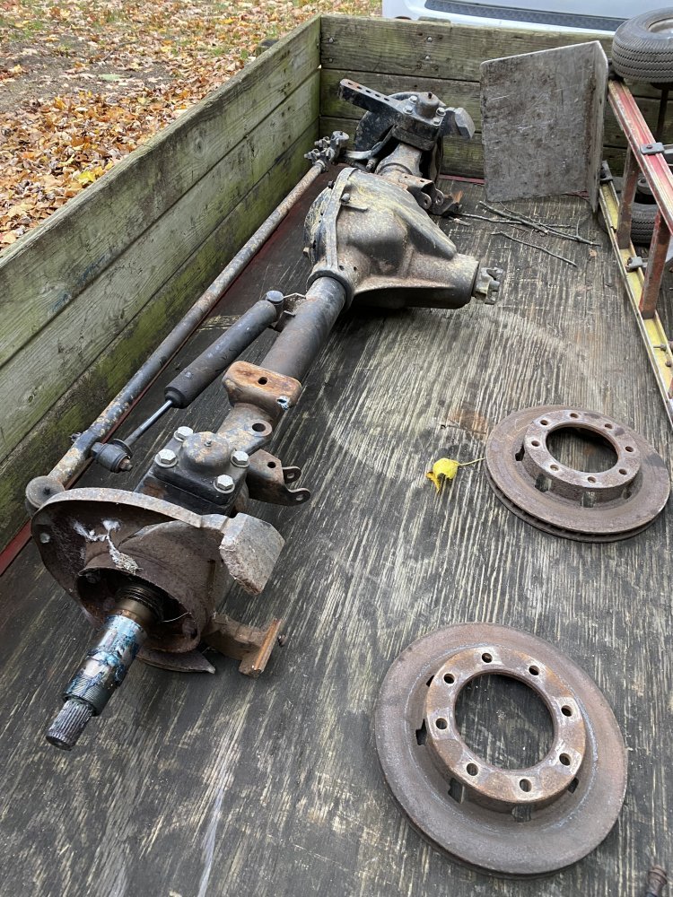

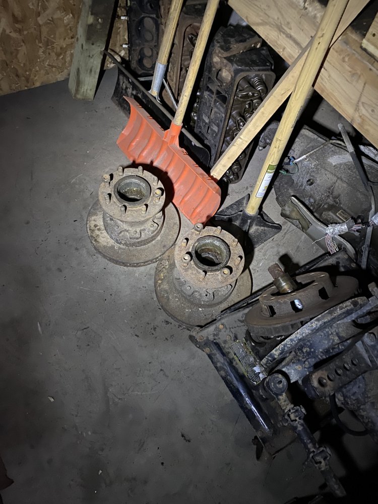

Next I found a Dana 60, so I grabbed that. It was missing the hubs, but I found a set of dually hubs nearby, so I grabbed those as well. The axle already had a crossover steering arm, so that's cool.
Yeah, so dually hubs..... I decided that even though I wanted to use those 16.5" kidney slots, that this truck was going to make much more sense as a dually since it will be a dump truck, so these dually hubs are actually perfect.

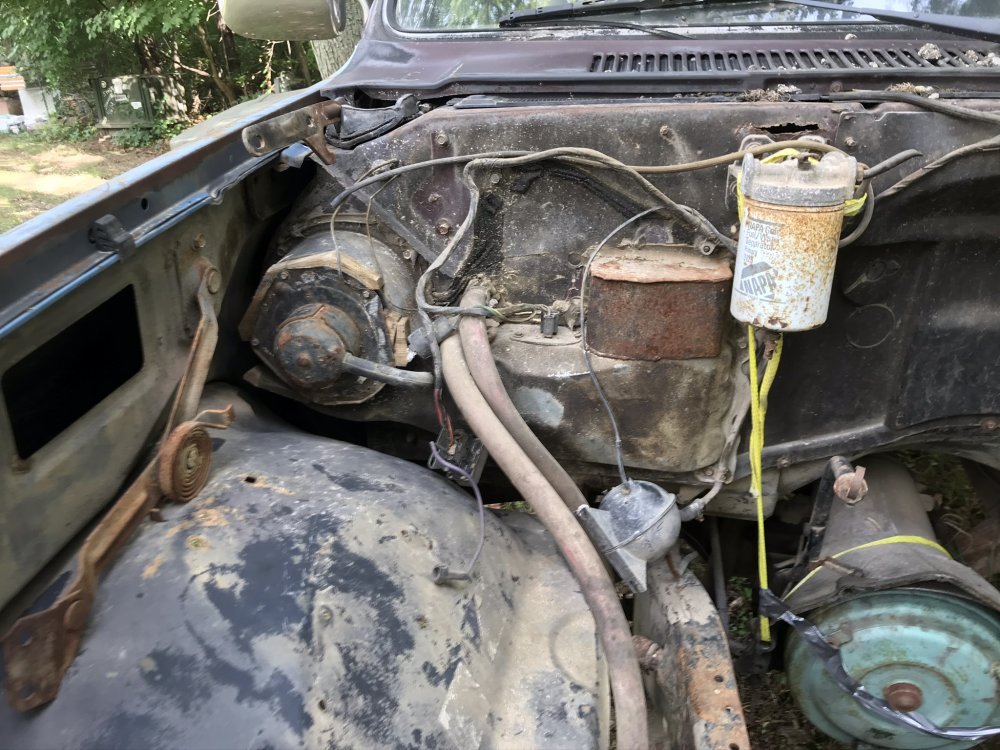

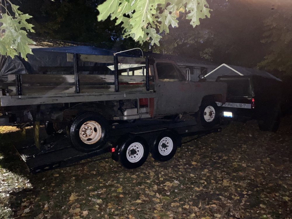

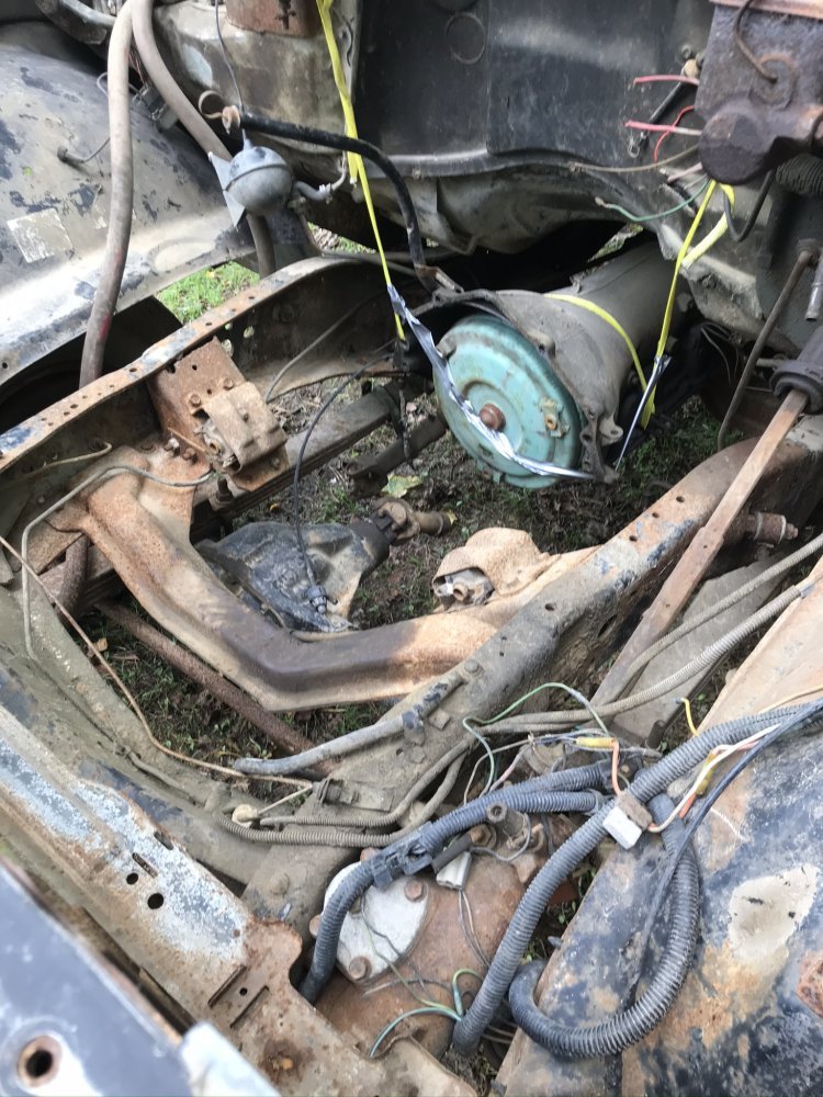

Clearly the PO was all kinds of classy (and lonely I assume)

Here’s the Dana 60. It has 4.56 gears in it.
And the dually hubs I got.

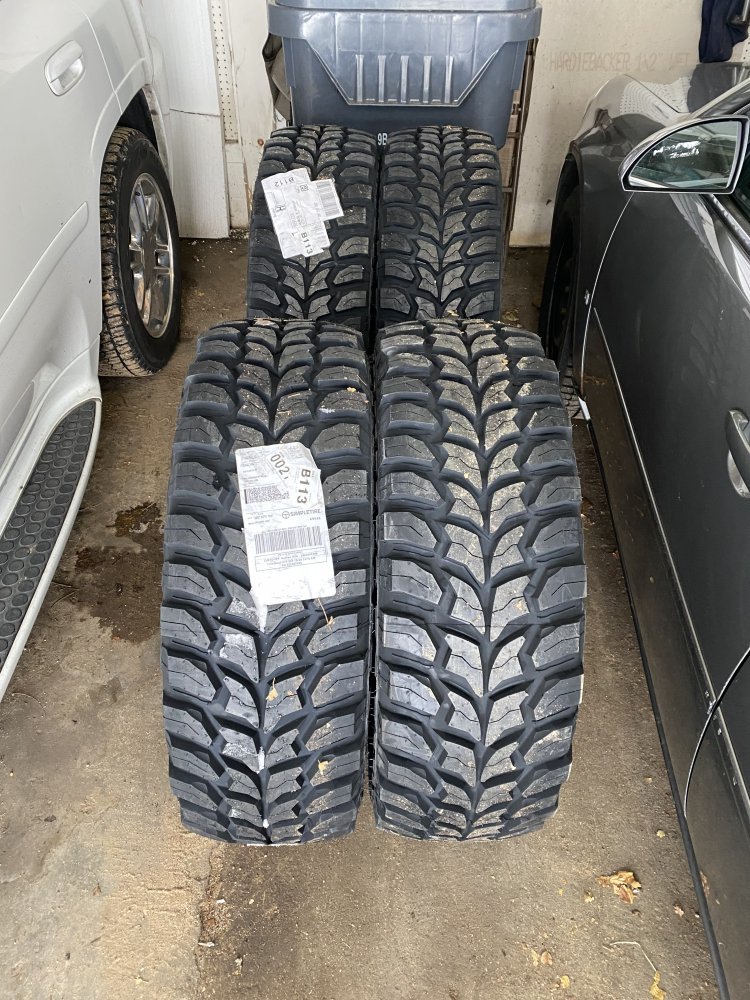

I ordered some 315/75/16 tires and 4 of the 6 showed up today. I’ve seen many people install this size tire on dually wheels and it works fine, but I’m not sure I’m thrilled doing that, so right now my plan is to widen the dually wheels from 6” wide to 7.5” - 8” wide. I’m going to do some test mounting and see what seems right.

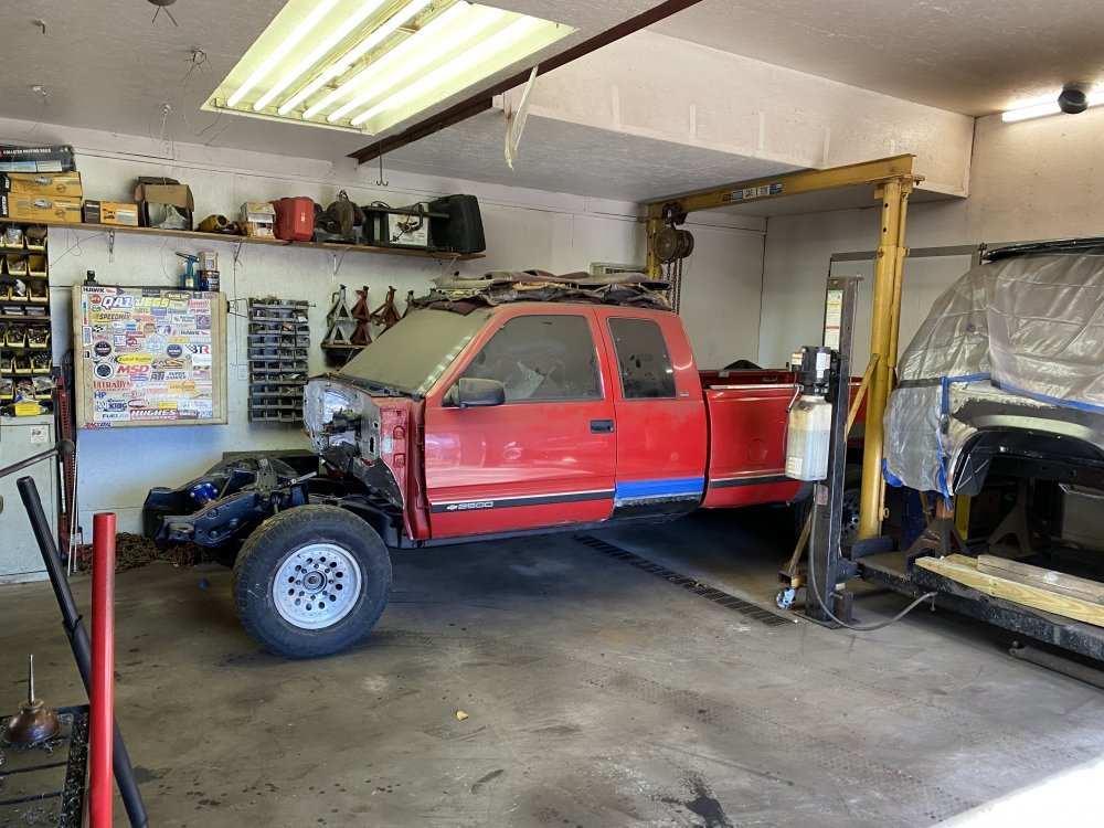

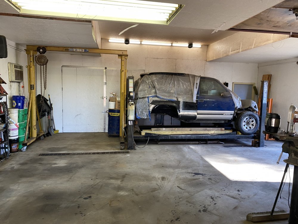

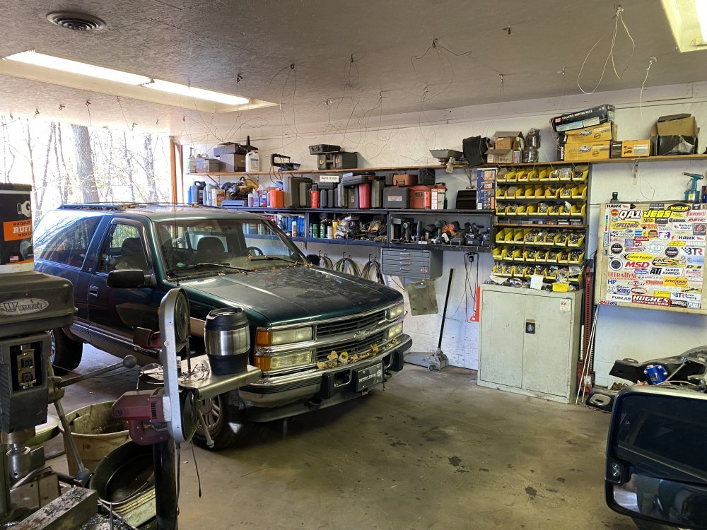

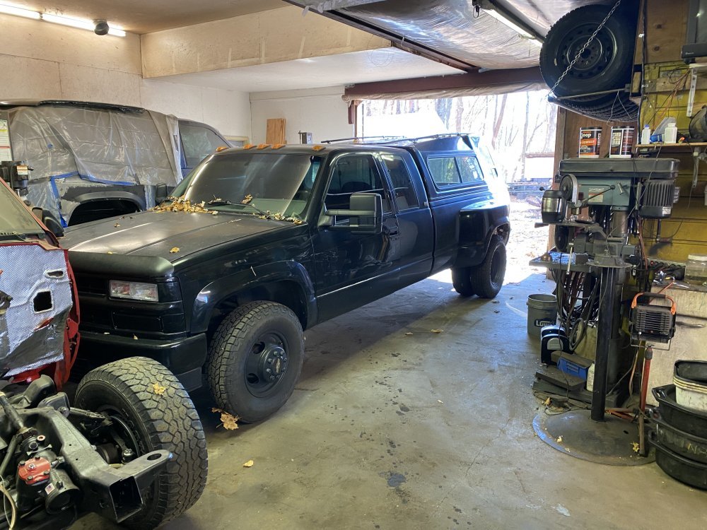

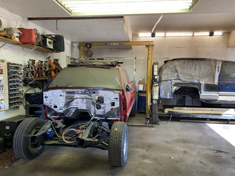

One of the steps I needed to take to get ready for this project was some rearranging in the barn. I’d have more workspace if I would get some projects finished, but that’s not how I roll, so here’s where I am. The space actually worked out exactly as I planned and I ended up with 2 work stalls open instead of just 1, so that’s a big win.

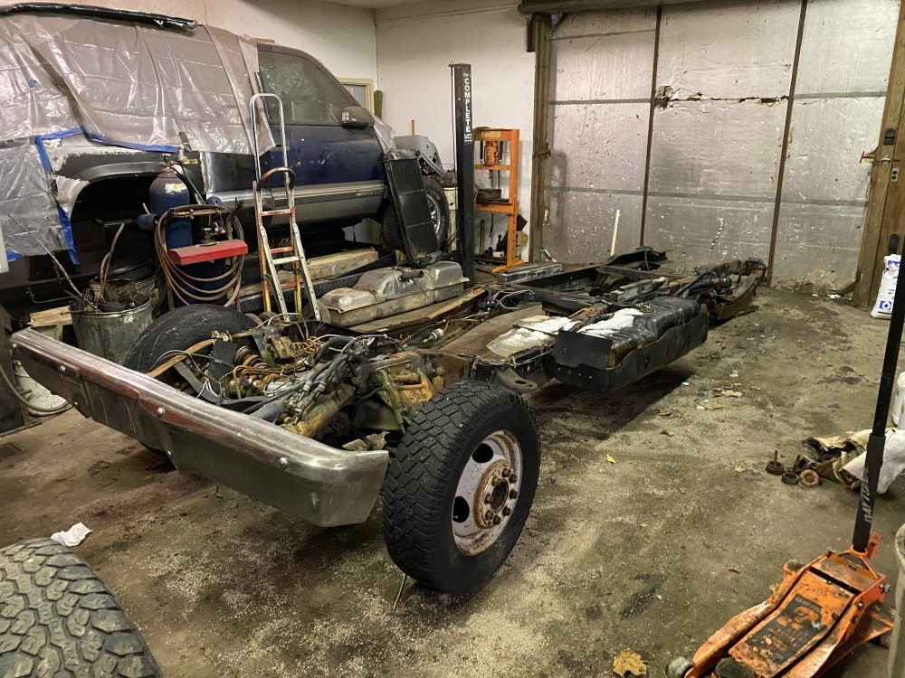

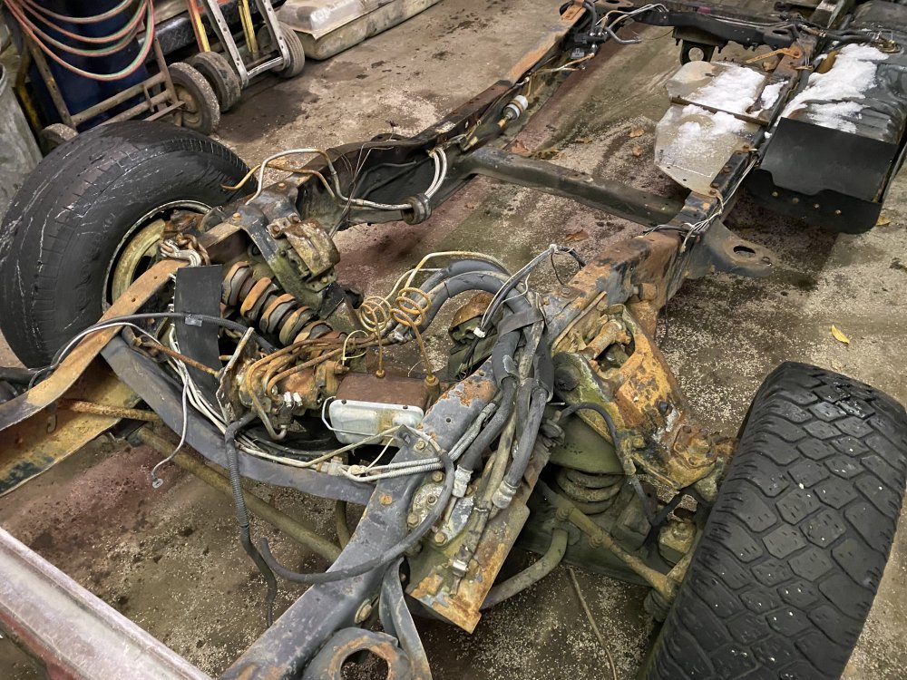

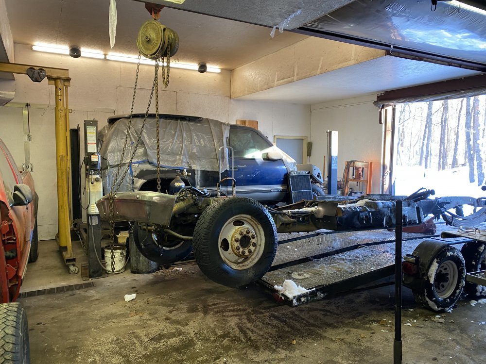

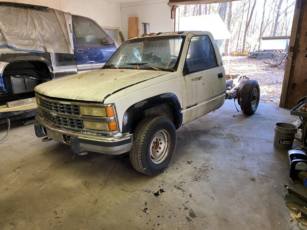

First up was parting out the 92 K3500 I got a couple years ago. It was in my way for digging the squarebody out of it’s current storage spot and this thing is always in my way, so I decided that if I took it apart it would be easier/more efficient to store, so I brought it in to disassemble. The frame is junk on this truck, so that’s why it’s coming apart. Unfortunately, this one has 3.73 gears, so that’s another 4.56 gear candidate that didn’t pan out.
Yes sir. I figured it was easier/more efficient/more practical to convert the longer C30 frame to 4wd than to extend the K30 frame I already had. Right now the C30 frame has about a 160” wheelbase, I think I want it a bit shorter than that, but I’m not sure how short yet….still, relocating spring hangers and then bobbing the frame is easy, so I think this is the right way to go. Another bonus with the longer frame is that the frame rails are made out of a little thicker material than the pickup length frame, so that’s a good bonus considering how this truck is going to get used.
View attachment 77754View attachment 77755View attachment 77756View attachment 77757View attachment 77758View attachment 77760

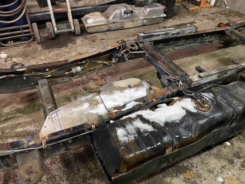

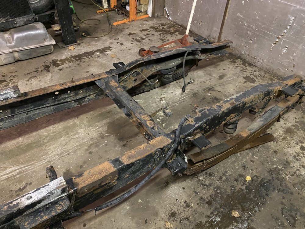

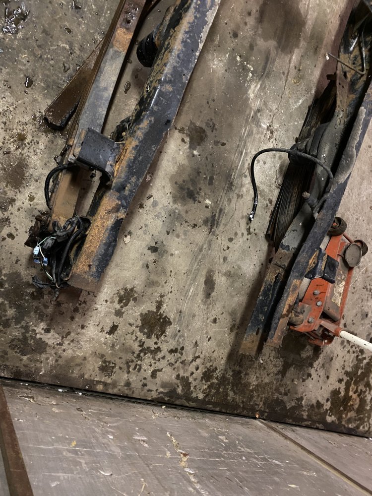

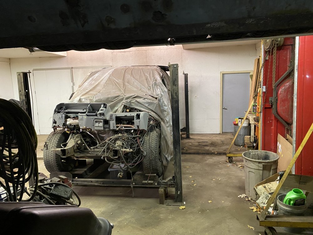

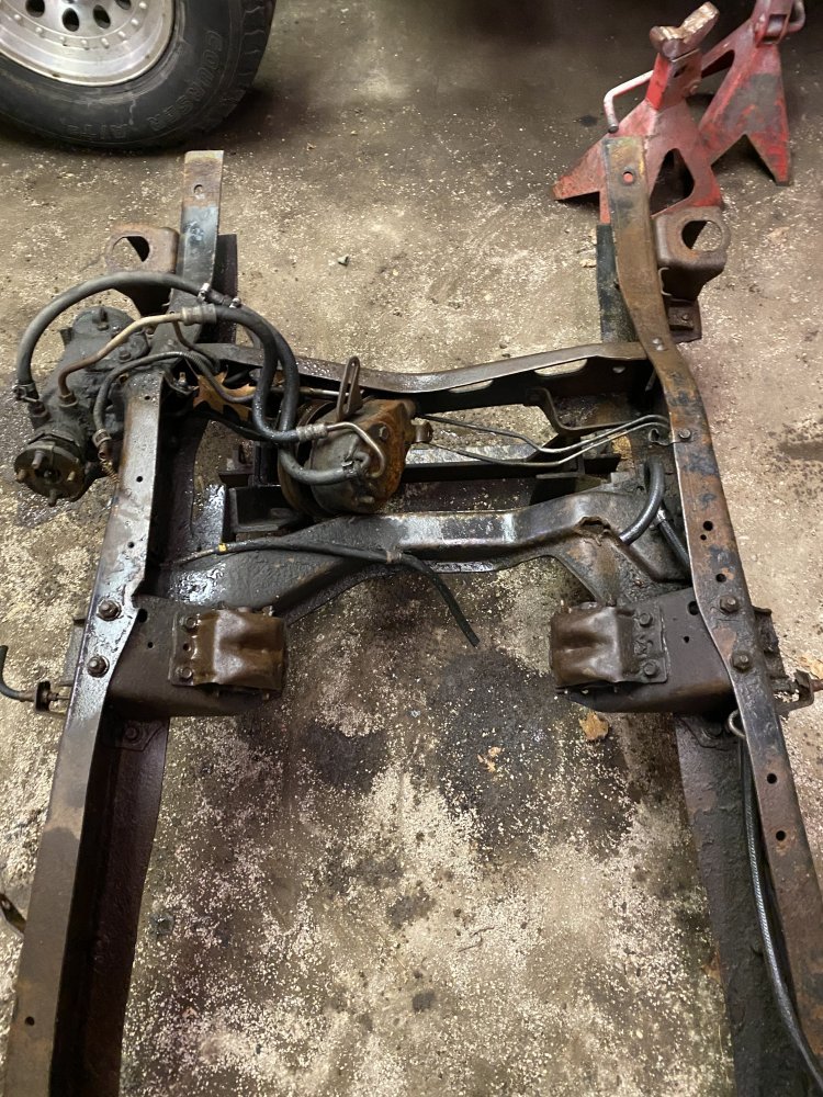

Made good progress this evening: I got everything stripped off of the frame. I got really lucky even because the leaf springs barely fought me coming off, which is very rare here in the rust belt. Tomorrow I’ll get things moved out of the barn and the mess cleaned up so I can start on the next thing. 35AD5229-924D-41CA-A343-A1BE967A8B93.jpeg

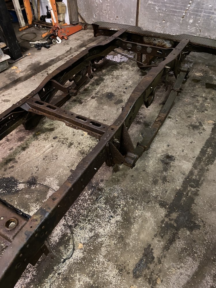

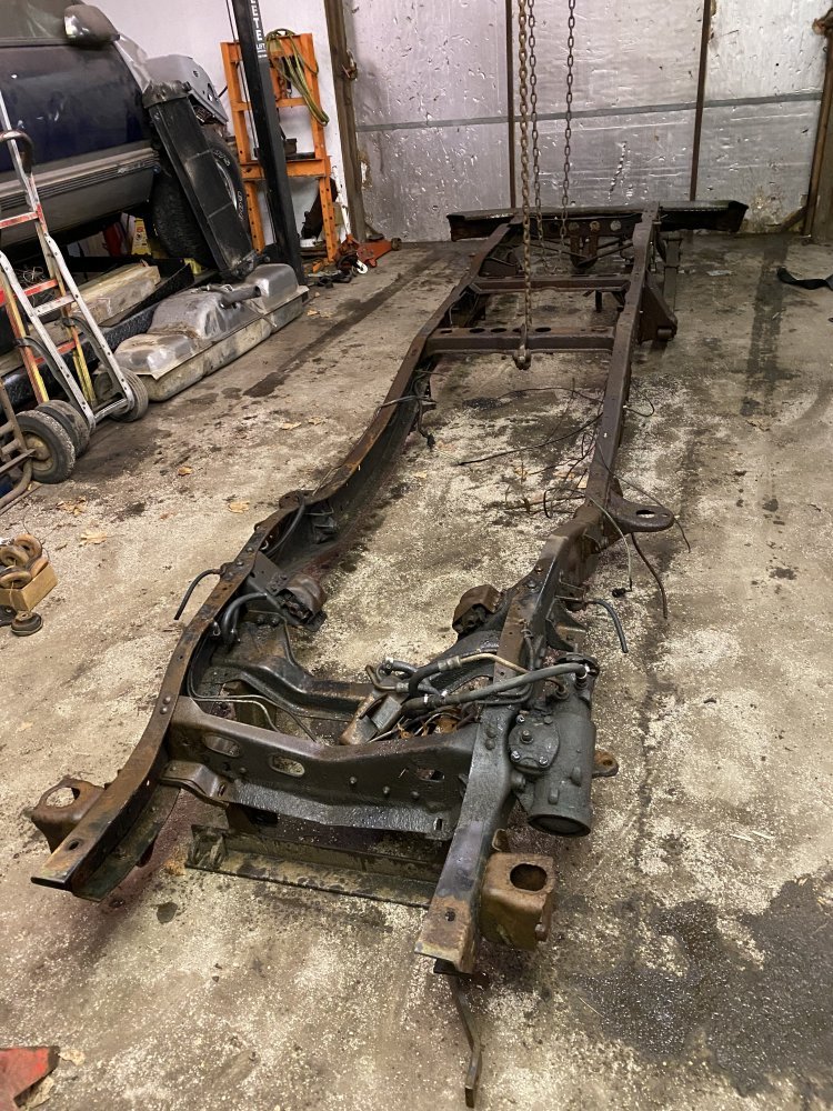

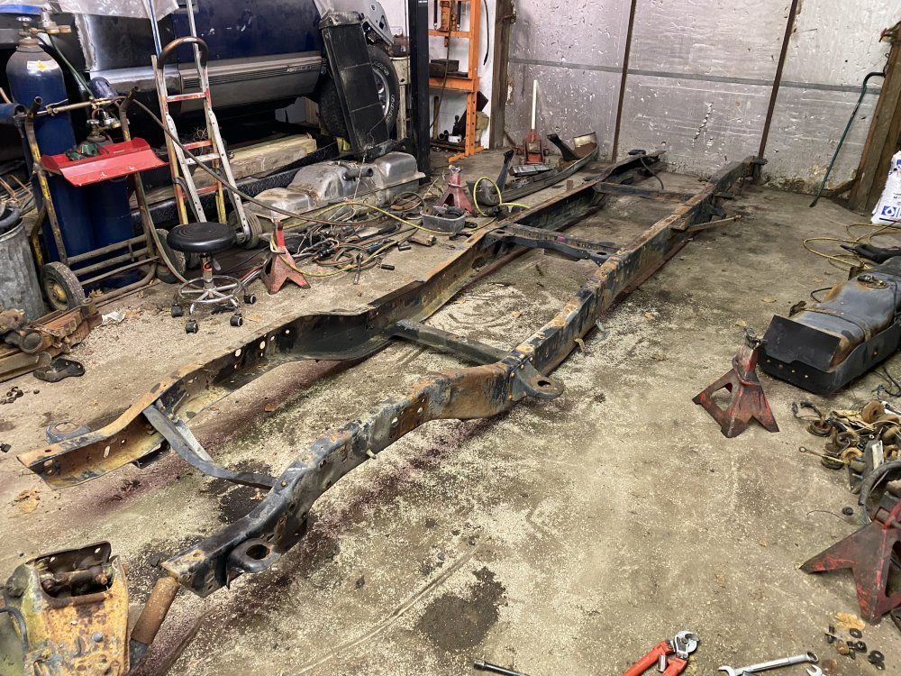

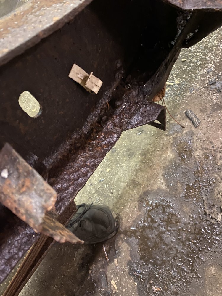

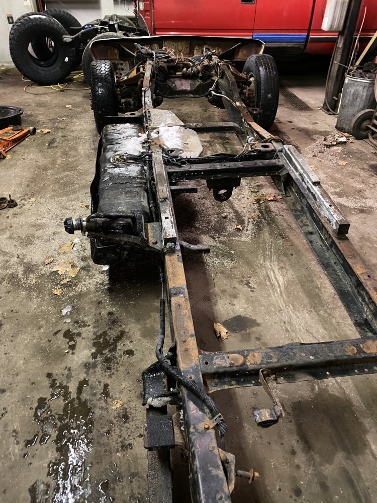

Picked up another frame today - this one is an 82 K20. Bonus is this one had a 6.2 originally so not only did I get a 4wd frame as a guide and parts for the 4wd conversion, but I also got the diesel motor mount brackets I needed, score!! The front is in pretty good shape, but the rear is in typical shape for around here, which is just fine for my needs.
F6D20AA2-CB15-4AD0-9A3E-6DDC1B374AF7.jpeg45191672-3D0F-4621-B41E-B0C095D1D3D4.jpeg3E2B92A2-20E2-46B6-8A2C-27207C8CCBBC.jpeg628FF686-364B-41B0-A080-2C715DB012B2.jpeg
I did some quick comparing between the 89 C30 frame and the 82 K20 frame and found that the K rails at the front are taller than the C rails are, so I’ll need to decide what I want to do there for the conversion. When it comes to that I’ll put the frames side-by-side and figure it out.
I also took a look at the original truck’s frame and found out that it’s not a K30 frame after all, it’s actually a C30 frame that someone converted to 4wd, so that’s interesting.

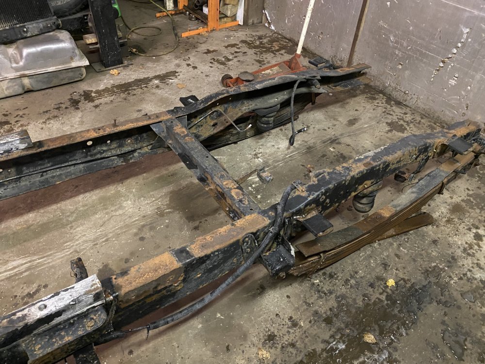

I got the K20 frame all stripped down this afternoon, so that was good progress. This week I’ll pull the frame out of the barn and then take care of the parts I removed from both frames to save. Once that’s done I’ll be ready to pull the truck into the barn and I can start making stuff happen.
