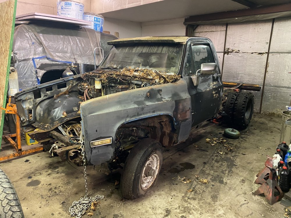

Today I took advantage of a break in the weather and pulled the truck into the barn. Only thing I did once I got it in was pop the diff cover off so I could check the gears - it has 4.10 gears, I was hoping for 4.56 so it would match the Dana 60’s gears, but no dice. So now I either need a thick 4.56 set or a standard 4.56 set and a carrier. That’s a while down the road though, this week I’ll start tearing it down and assessing the condition of the cab.

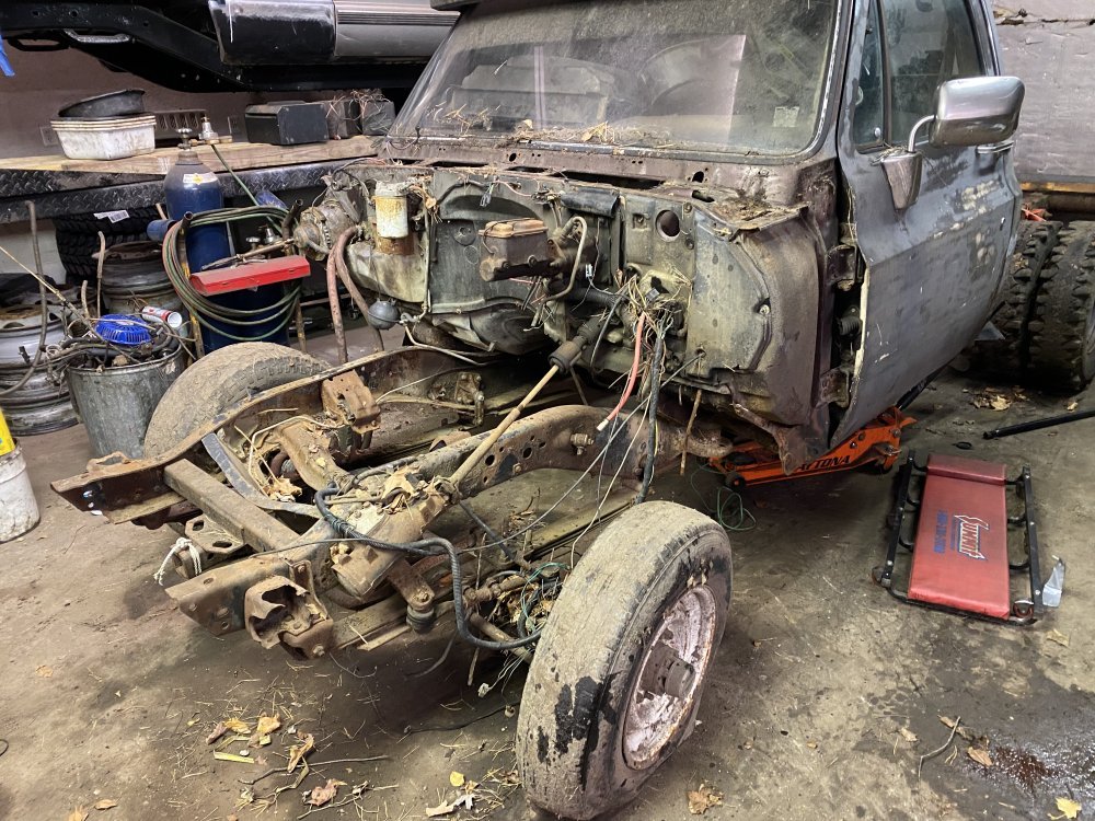

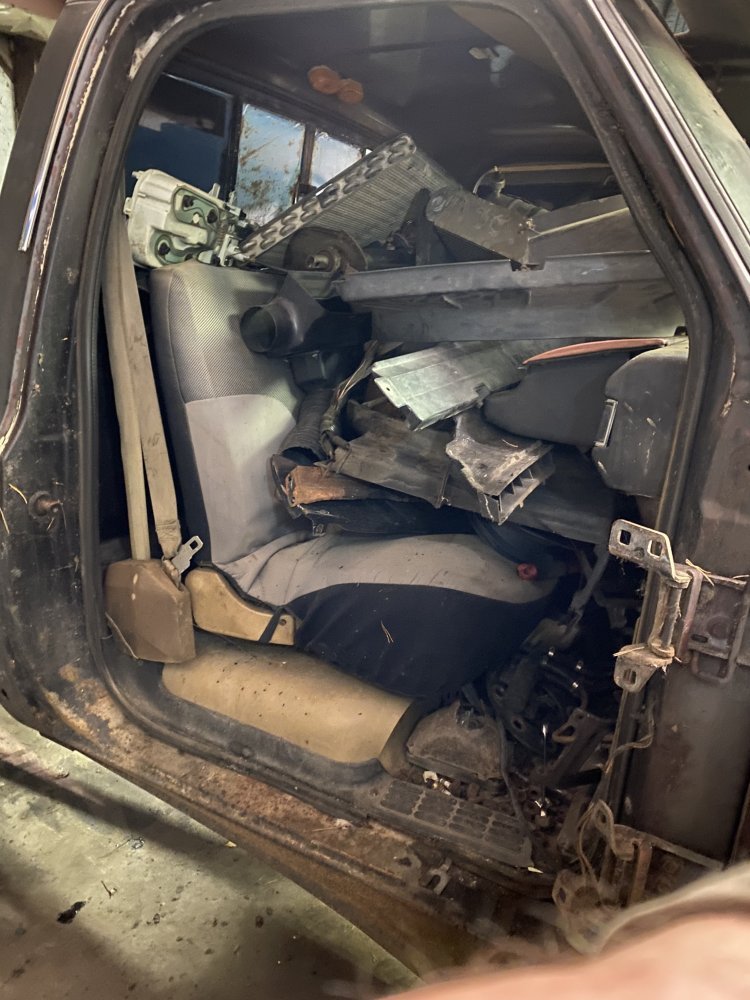

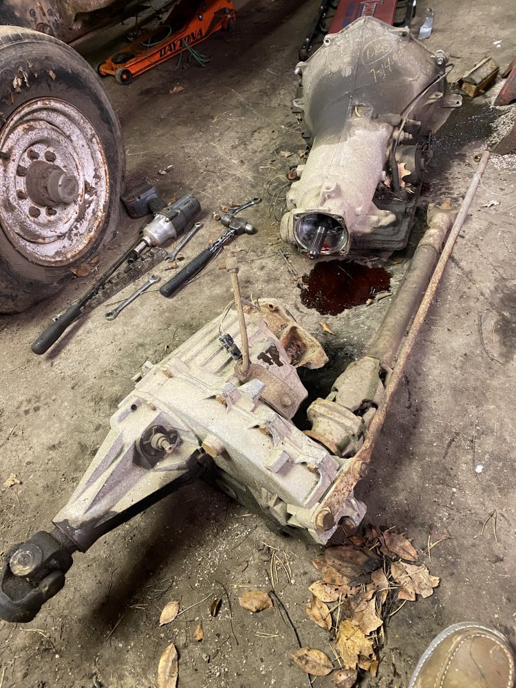

I’ve had to do a little rearranging of things in the barn so I can store the parts for this project more effectively, so my progress isn’t as good as I would like, but still not terrible. So far I have the front clip off and some parts off of the firewall. I also got the 700R4 and NP208 pulled that came with it. Last thing I did today was remove the doors, which will make it easier to remove all the parts for this project that I’ve been storing in the cab.
0E05D3AE-98FD-4B0C-A9BD-7391FC7B5DB6.jpegCB51886C-496C-4FD0-A331-6BD7E2920A16.jpeg89A147D4-1070-4F98-90F5-C2A928332F1A.jpeg34828A8C-85FA-45D7-B85D-8C9551E705D1.jpeg
I have a better idea, Nate. Call Danielle and see if Mike and Frank from American Pickers can come over and go through that cab, and then your buildings. Who knows what treasures they might uncover, they might even find a skidsteer! 🤣🤣🤣

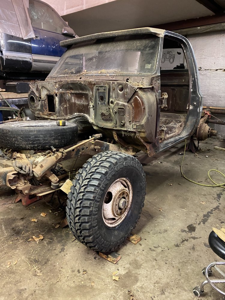

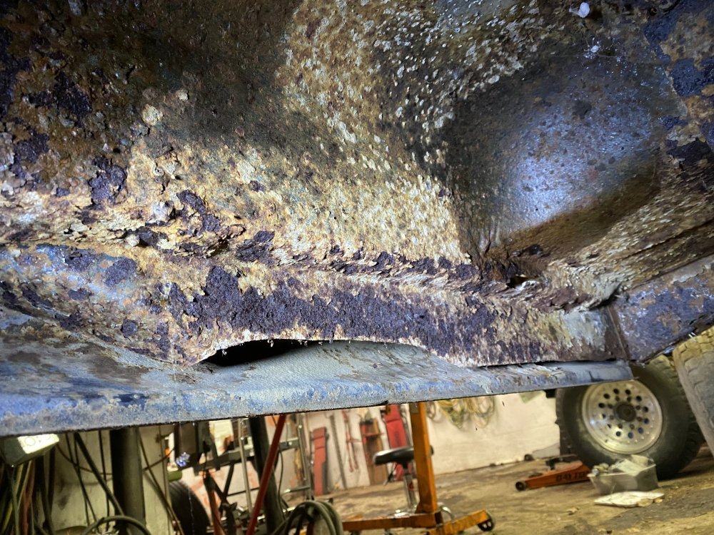

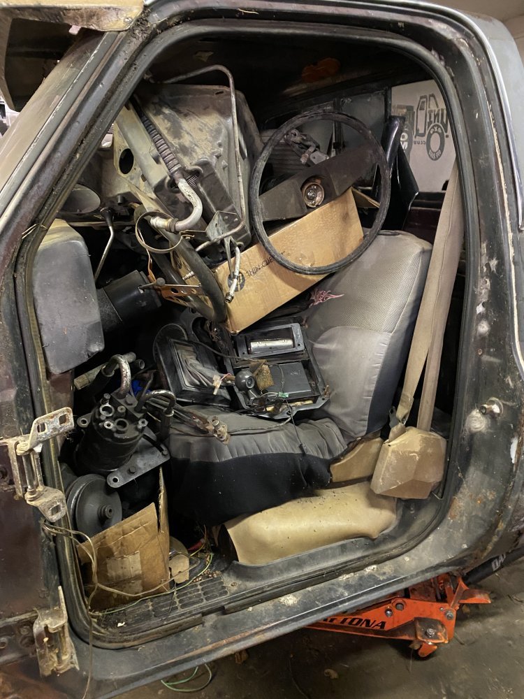

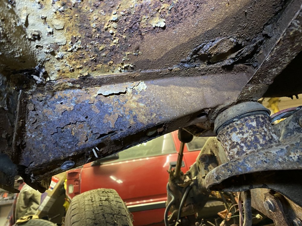

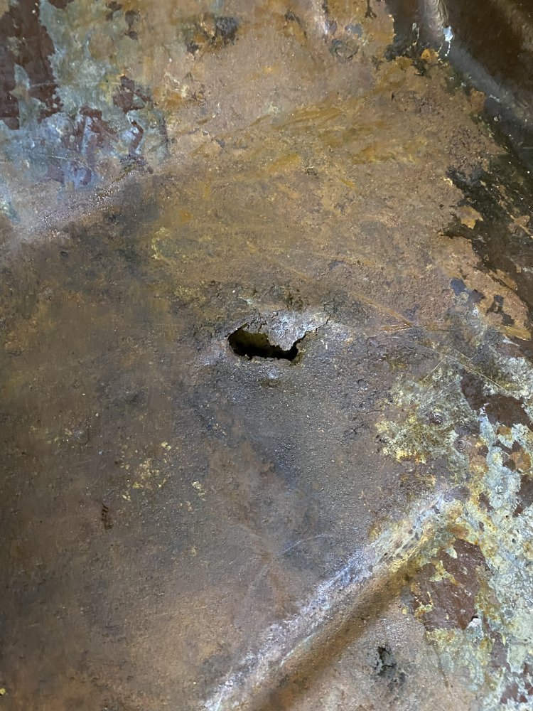

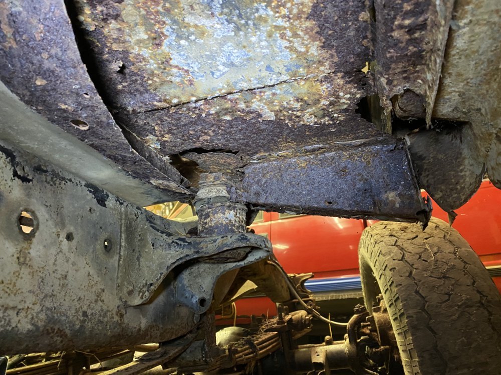

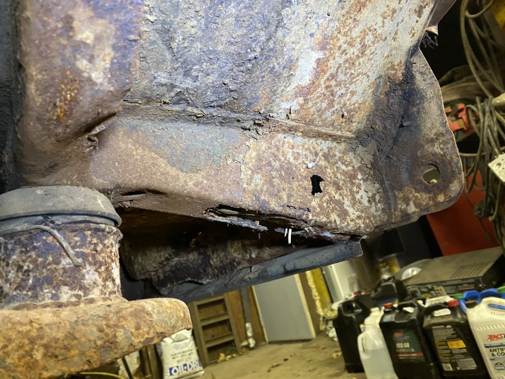

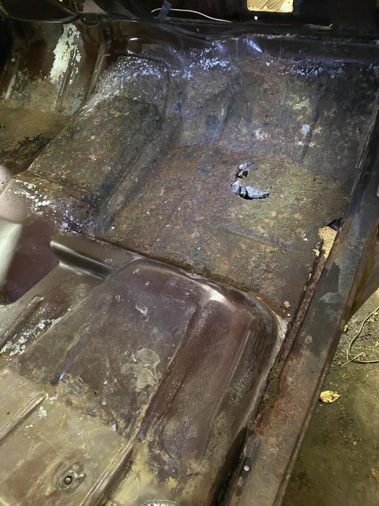

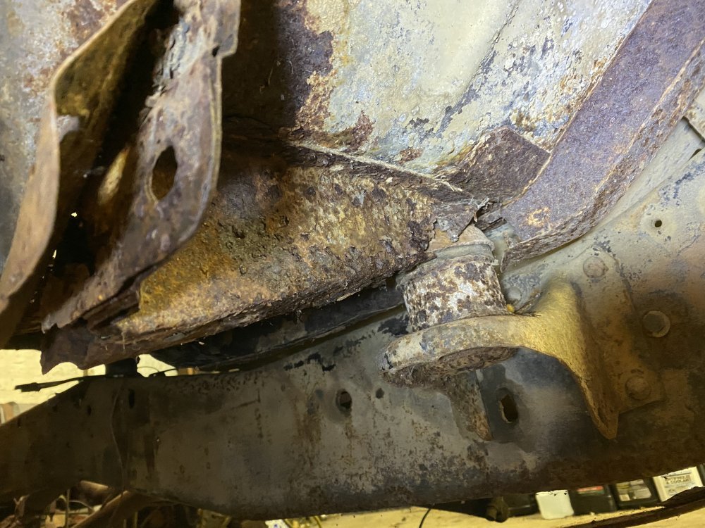

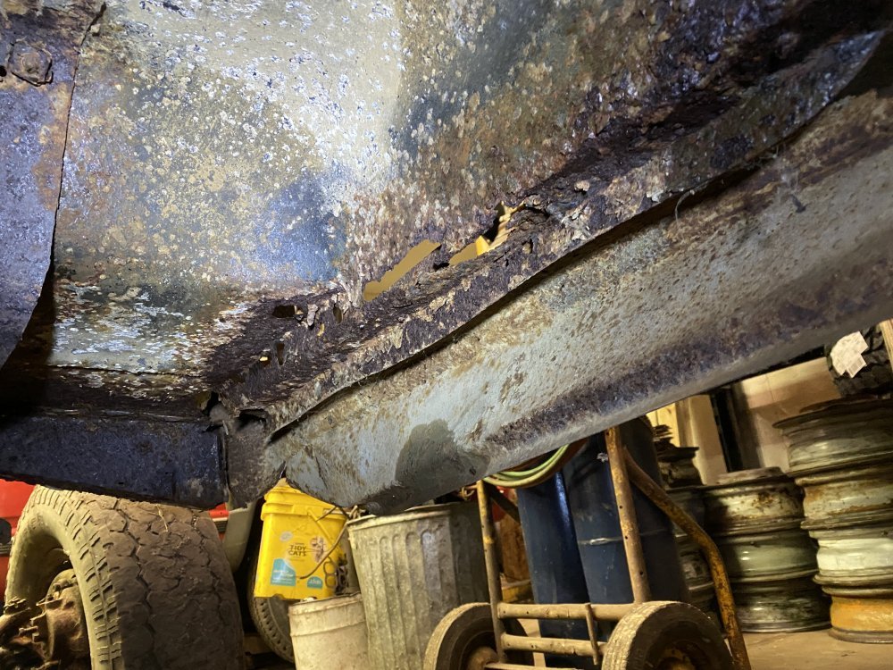

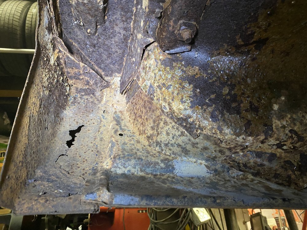

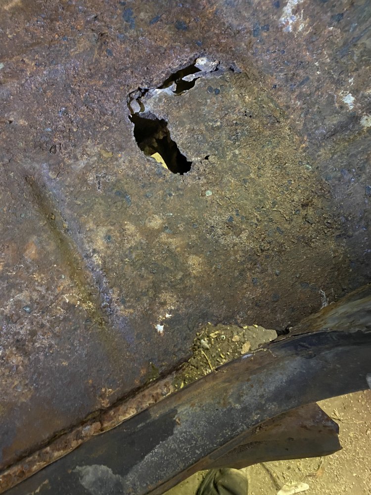

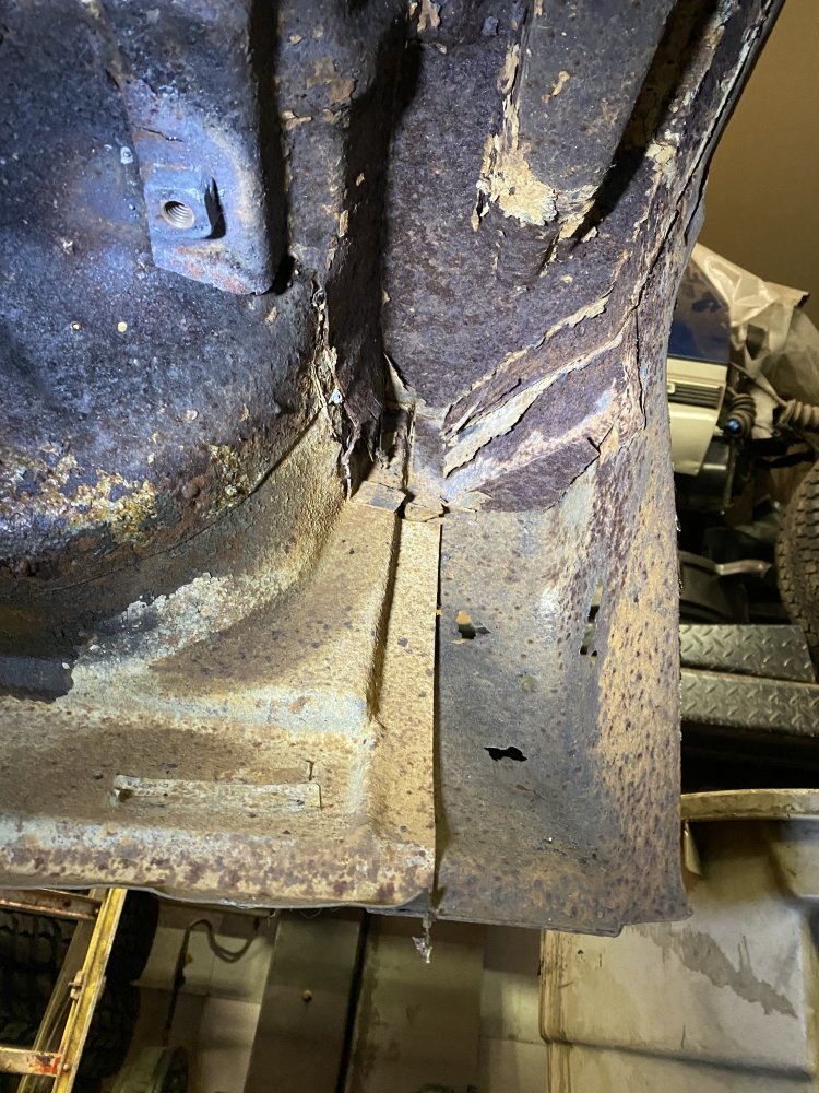

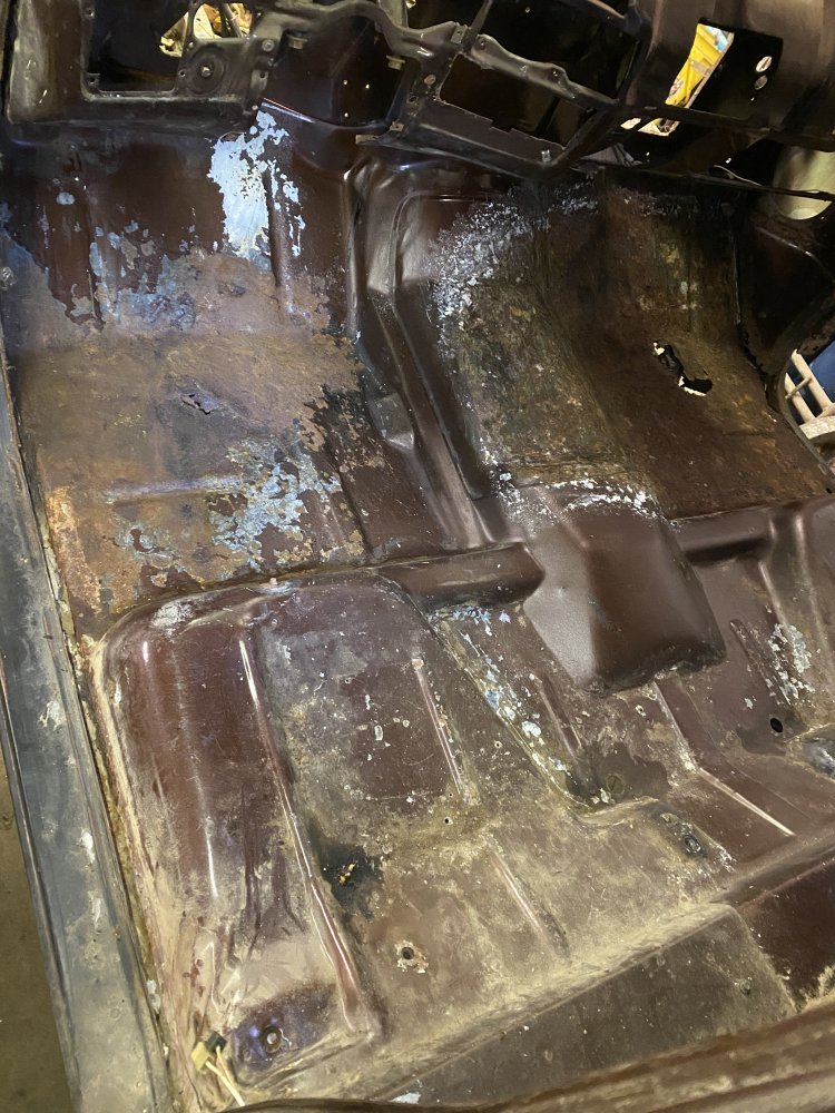

I got the cab emptied and stripped. It’s a bit rusty, to say the least. Somebody else already did a rocker and cab corner job on it……badly. I can get all the panels to fix this, but I’ll first look to see if there’s a better cab to start with since this is so bad and already molested.

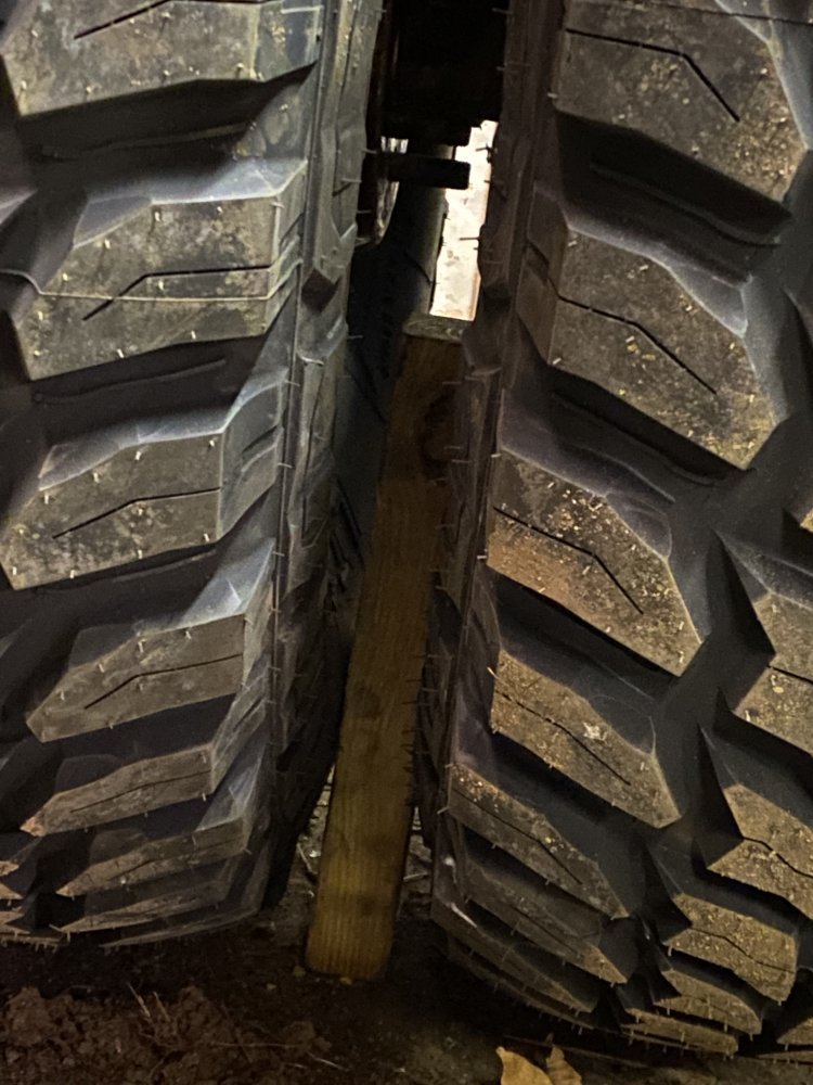

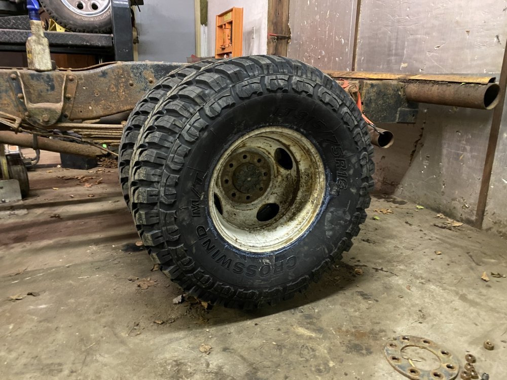

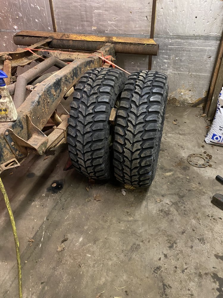

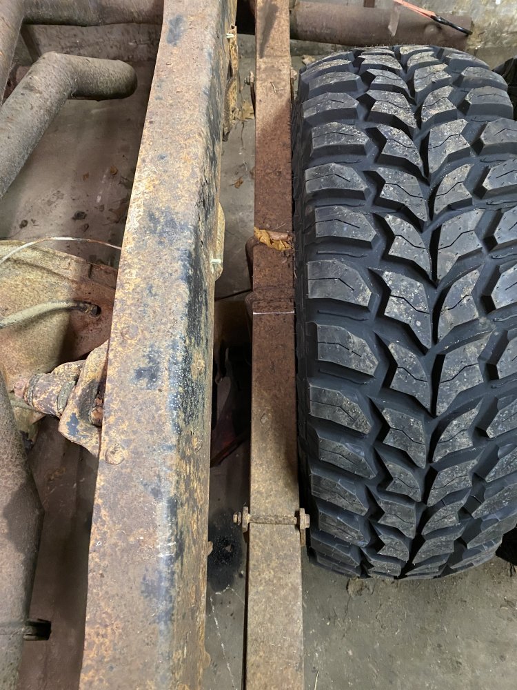

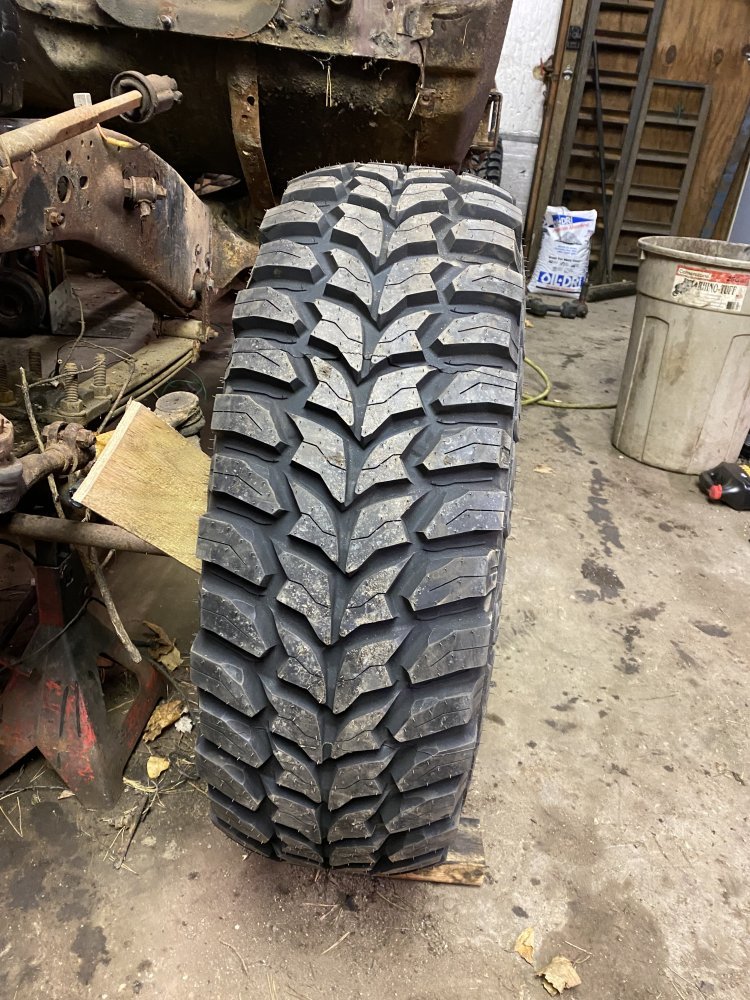

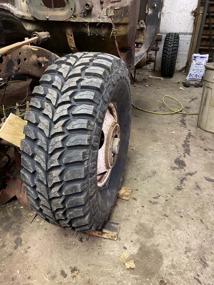

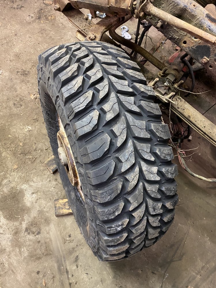

I think I’m going to step away from the cab for a minute and let a plan for what I want to do develop/marinate, and/or see if something presents itself. Before I rolled it out so I could start frame stuff I decided to test fit the tires. These are 315/75/16 tires. The minimum recommended rim width for them is 8”. These dually wheels have a rim width of 6”. I’ve read of numerous people running this exact combo and being fine, even towing….and since everything on the internet is true, I should be fine, but…..

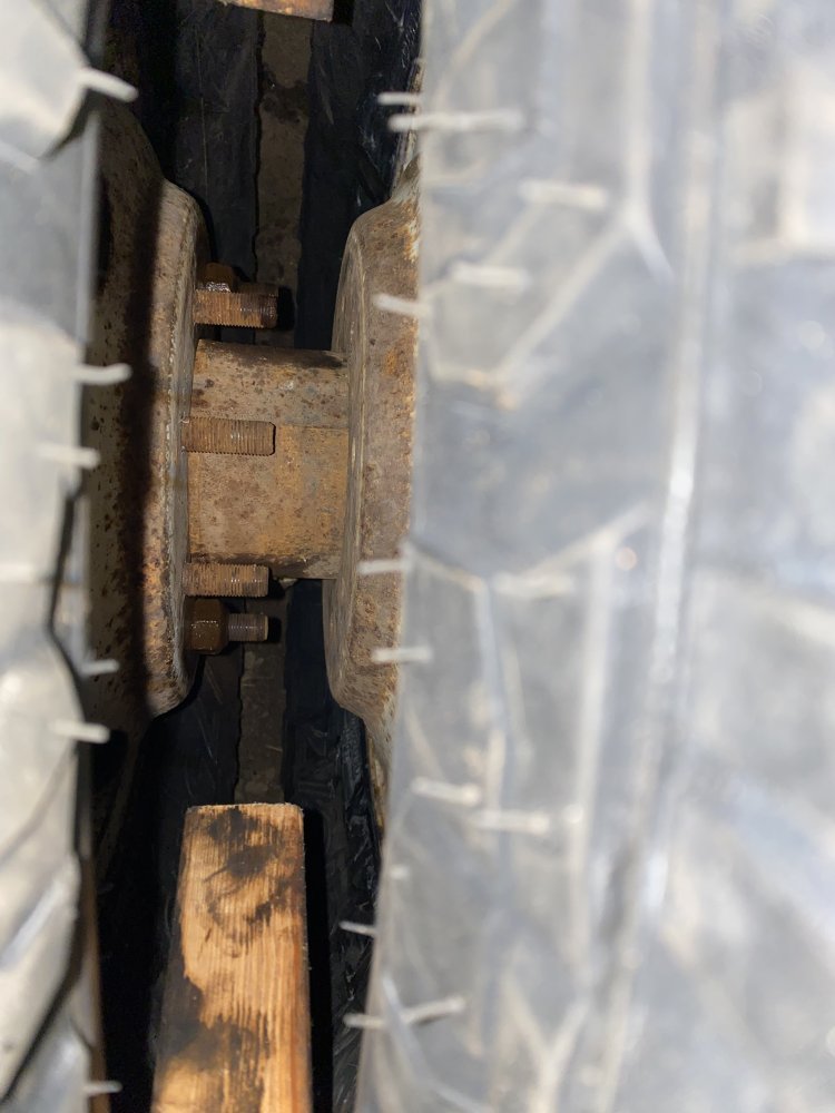

I’m just not sure what I want to do though. I have been working on a plan to widen my wheels that I know will work, but it will be a lot of work to do that. And if I widen them, which direction should I go? Or should I go both ways? There are advantages to all options. Regardless of which option I choose I will need spacers in between the rear wheels, but the actual thickness of it will depend on what I do with the wheels.
With the way this is mocked up, if I stay with 6” rims, I will need about a .5” spacer behind the inner dual since it’s solidly on the spring right now (this is a cab and chassis axle so it’s narrower) and this represents a 2.75” spacer in between using the 2x4s to space for mockup. I could probably get away with 2.5” since there’s 1.5” between the tires right now due to my 2x4 mockup spacers.
I can make a dually wheel with a 7.5” wide rim with just one seam using a combo of single and dual wheels, which I think is close enough to the 8” to be ok. If I add that to the convex side, that should get me far enough away from the spring that I then won’t need an inner spacer (I’m figuring the sidewall will move half of the additional rim width, so .75”), but then I’m going to need 4” of spacer in between the wheels (2.5 + .75 + .75).
If I add the 1.5” to the to the concave side, I’ll need probably 1.25” spacer behind the inner dual and then about 1” between the duals (2.5 - .75 - .75). I hadn’t done the math until now….those thinner spacers sound better than the 4” spacer.
Or if I make a wheel that has an 8” wide rim with 1” added to the concave side and 1” added to the convex side, I think I will need the same spacers as the 6” combo. One advantage to this combo is that my scrub radius in the front will be the same as stock.
So I have a few routes I can go. The easiest is to keep the 6” wheel width and bolt on the necessary spacers. If nothing else, I could start this way since I’ll just be using the truck for trips up and down the road to move dirt and if I find issues then I can change the wheel situation later.

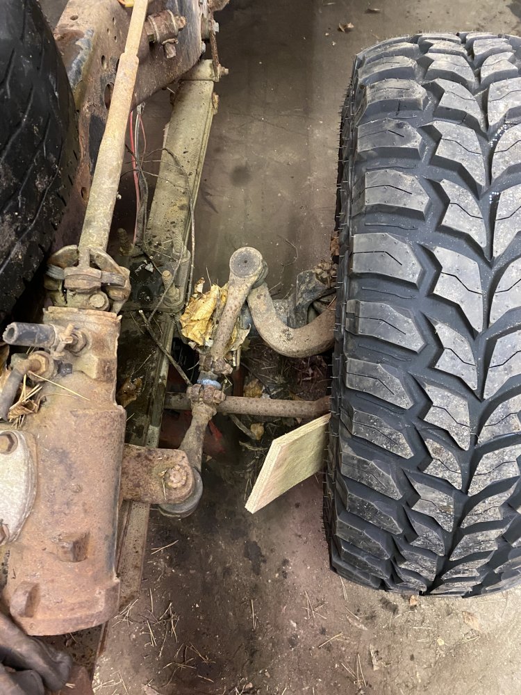

I also test fit in the front just to see. Right now it hits the pitman at full lock, but in reality that won’t happen when I’m done - 1. I’m going to have crossover steering instead of the stock push-pull situation, so it won’t be in that same spot and 2. I’m going to have 8” lift springs in the front so the center of the tire will be much lower.
Does anyone have real world experience with wide tires on narrow rims to share?
