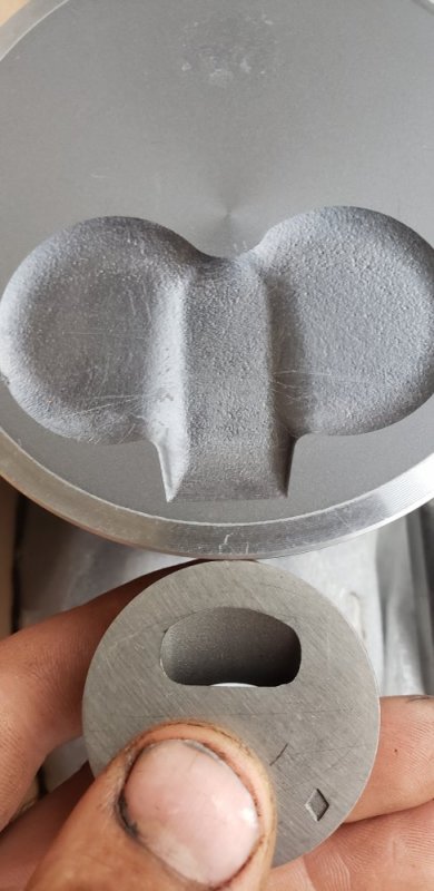

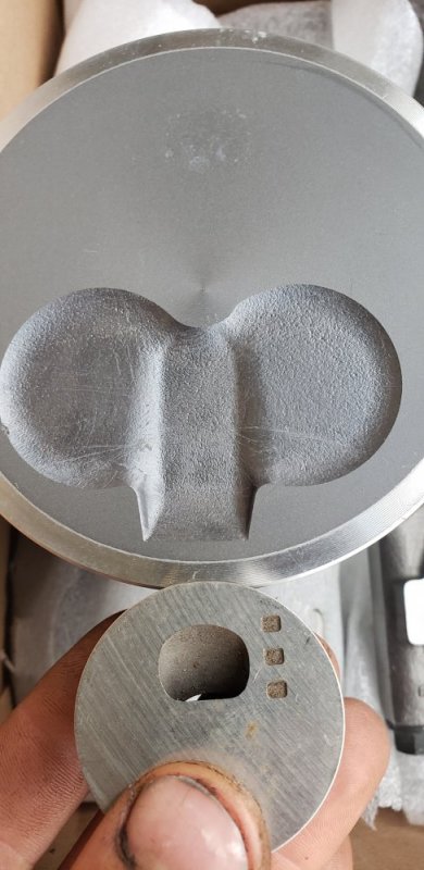

It's been a while since I've posted in here. But my research still continues. Mostly I've been focusing on injection pumps. But I wanted to share some precup related stuff I forgot about. I took pictures of the diamond and square cups and compared them to the channel in the piston. To me it looks like the square cup does a better job or concentrating the flame front into the channel. And the diamond cups may spread the flame front out side of the channel.

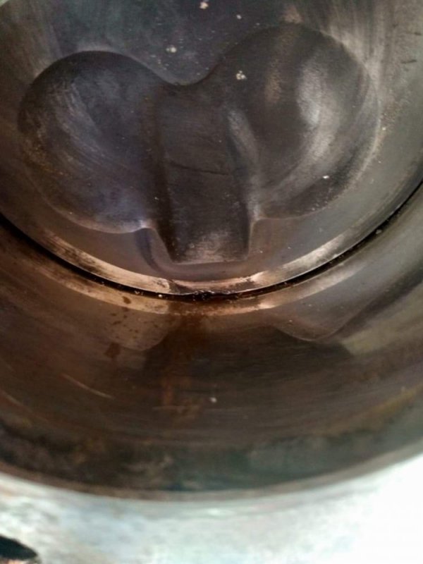

This last picture is a used piston that was running diamond precups. You can clearly see the witness mark the flame front left on the outside of the channel. Now this wasn't my engine so I can't confirm if it have thicker head gaskets or not. But it was definitely a diamond precup. I would imagine thicker head gaskets would widen the flame front due to the increased distance between the cup and piston. But I can't confirm that's what happened here. In my opinion the distance between the cup and piston should not be changed for this reason.,

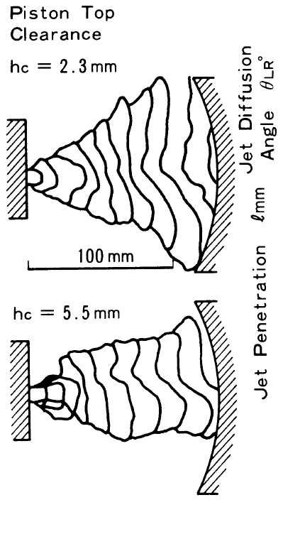

It is probably the diamond precup causing the wide burn mark there. According to this diagram from the above article, a tighter piston to head clearance makes the jet spread out faster (hc is head clearance here). Imagine the way a bead of silicone spreads out when it's squeezed between two surfaces.
