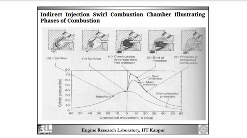

I found a research paper "combustion characteristics of a swirl chamber type diesel engine" and it had some interesting information. It compared different pre combustion cup throat sizes and angles and what effect it had on the combustion process. Here is where things get interesting. I'm going to focus mostly on throat sizes because that seems to be the biggest difference between all of the cups offered in the 6.x platform.
The smaller the throat size the greater the velocity entering the pre combustion chamber. And it has the same affect on the air/fuel mixture leaving the cup. More velocity equals more atomization. It also speeds up the combustion process. Faster burn makes higher cylinder pressure causing a harder push on the piston. In other words more power!!!
A larger throat has the opposite affect. Slower velocity in and out of the chamber resulting in less atomization. Creating a longer burn time making less cylinder pressure.
Compression ratio can also have an affect on air velocity into the chamber
With this information I think there may be an advantage to using the smaller pre combustion cups. But to get the best affect the correct injector flow rate curve and spray pattern need to be used with the smaller cup.

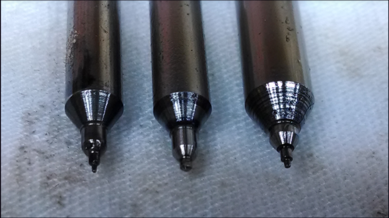

I still think that the 6.5 injectors and turbo cups are designed for emissions. The 6.2 uses a nozzle design similar to the 7.3. But the 6.5 nozzle resembles those found on small economy diesels over seas. Gm used the same nozzle (dn0sd304) on both the 6.5 n/a and turbo engines. The pintle design creates a slower, complete burn by flowing fuel more evenly across all stages of lift. The 6.2 pintle on the other hand increases flow more as the needle lifts. If you compare the pintles you'll find that the 6.5 has a flat spot machined into it that the 6.2 doesn't have. I think the 6.5 nozzle flow rate curve was the reason that the cup throat was opened on the turbo engines. Boost increased combustion speed and a bigger throat was needed to slow it back down to keep soot levels low. But there is a fine line because the more you slow it down the more NOx it will generate. Throat angle also plays a role but I have to physically measure that to see the difference if any between the cups. I believe cup volume is determined by engine displacement and static compression ratio. Different throat area and angles are used to adjust the combustion characteristics.
(6.5 stock - Marine - 6.2 long)
So I think the injector flow rate curve plays a big part and this diagram might help me explain that better.
As you can see the injection event starts BTDC and ends ATDC. Fuel injected BTDC is to start the combustion process and raise the chamber temperature and pressure. Fuel injected ATDC is used for additional combustion in the main cylinder. Injecting more of the fuel volume BTDC increases the amount of combustion in the chamber. This is exactly what the 6.5 pintle does. Increase fuel volume to performance levels and it could lead to a poor incomplete burn in the chamber, and lowered cup temperatures. I think to get better combustion a smaller amount of fuel should be injected BTDC then a large volume of fuel injected ATDC at peak cylinder/cup pressure. The larger pressure drop from smaller cups will help mix the air/fuel and a bigger combustion event will happen in the cylinder. With the flat spot machined into the 6.5 pintle this flow rate curve would be impossible to achieve. 6.2 pintles have a more desirable flow rate curve. But when increasing fuel volume they might become restrictive and need modifications. But since these are mechanical injectors there is only so much that can be done to them.
I believe timing, pump volume, injector flow rate curve, pop pressure, boost pressure, static compression, cup volume and throat size all have an effect on one another. You need the right combinations of all of them to get the desired combustion event. This is why n/a cups, 6.5 nozzles, and increased fuel and boost numbers don't play well together. I don't believe the "super swirl" theory. There might be a point where larger cups are needed but I don't think we are even close to those fuel volume numbers yet.

I think the angle change and use of short injectors was done to help clearance for the turbo manifold. The long injectors will not clear the stock 6.5 turbo manifold. But that's fine with me. I wouldn't waste my time running that engineering master piece. I was going to run a sidewinder manifold.... But I don't like side mounts on v8's. So Im building a center mount set up for mine.
On a side note the short 6.2 nozzle might work also. But I haven't got one in my had yet to see what the flow rate curve will be. If anyone has any dn0sd253 nozzles I would love to have one.
