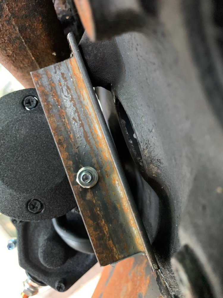

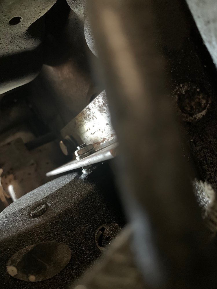

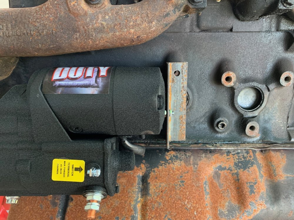

on the bracket, I simply cut a longer piece of angle iron and drilled two hole matching the factory bracket. the length was long enough to reach to just above where the oil pan mates on the block so that the bracket had two areas to press on to the block to stop the bending since my block had been repaired. the factory bracket would bend and allow the starter to slightly pivot closer to the block in the bracket area.
Do you remember what size angle iron?
1"x 1" x 1/8"?

Yes, 1" x 1" x 1/8" I couldn't measure the length but I think it's around 6-7" long. I took a couple pics of it on the truck and found the ones I took when I had it on the 6.2 block during mock up.

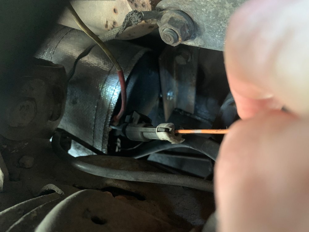

I did order a heat wrap for the starter from amazon since my factory one is missing. I have it wrapped but I found out you have to insulate the battery cable connection since the wrap seems to be some sort of foil infused fiberglass wrap and was arking on the terminal!
Here is the wrap I used.
Thanks again. having the length really helps.
