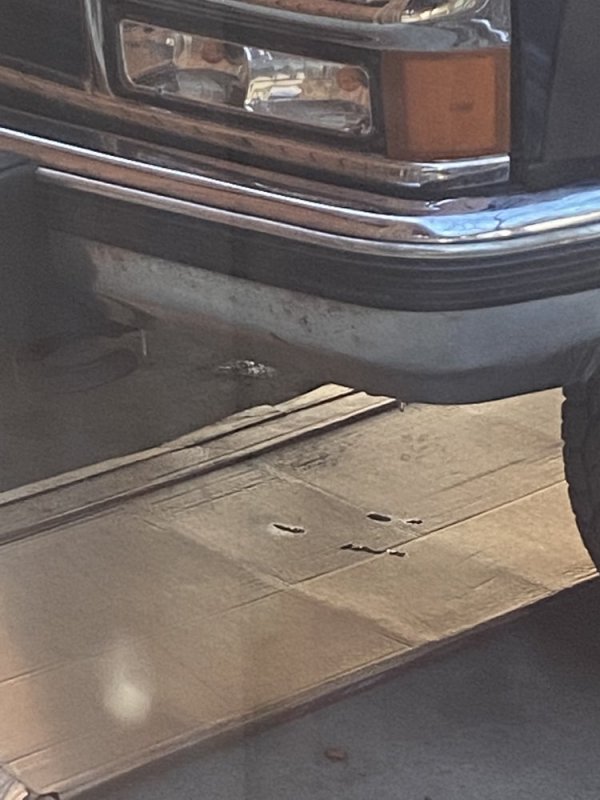

Moved the ‘99 from the mechanic’s over to our house and plugged it in. Went out to start and drive it in the afternoon and it started easily, but then a groaning sound came on. It would vary with engine speed and when turning the wheel. Took it for a short drive anyway. Glad I am replacing the transmission as there is engagement delay in both forward and reverse. Sound eventually disappeared on the drive, but notices a puddle of fluid on the drive about where the power steering pump is. I threw a piece of cardboard under there and there are some drops, but not as much as the initial puddle:
I have no experience with power steering other than replacing the fluid. Suggestions welcome.

Inspected it and it's been leaking and looooow on fluid. Looks like the hose directly below the filler cap has leaked and another hose that comes from the steering box to the back of the pump reservoir has leaked. Not sure what that one is called.

I checked and there's a decent amount of fluid on the cardboard. It could be from overflows during the repeated fillings. It's too cold to take it to a car wash to spray everything off as it would just freeze on the drive home. I will do additional runs and tests to see if there is additional leakage.
