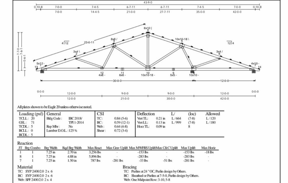

We are just waiting on the engineered truss drawings for submission to the permit department.

Yay! Just watch that the roof's rake does not impinge on the RV's roof line.
Luckily my current camper is very streamline and low at a height of 10' 3".
It is my understanding we will be about 16' since we are going trusses across the 42' width.
Waiting for the engineer to stamp the truss drawings. We decided to have the peak be centered over the entire building with the lean-to. I think that will look the best and ensure a taller ceiling for the lean-to.
