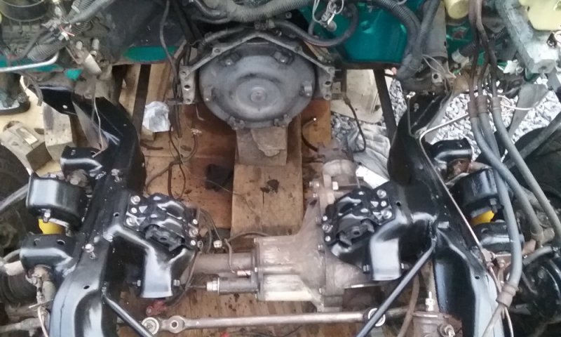

I won’t get tired or sore from you doing your motor mounts at all! Haha
But yes do both and trans mount all together, well motor mounte with jack under engine. Then after that do the trans mount.
Since you have shroud out, easier now.
personally I like factory rubber mounts not the vibrate your teeth out ones that last longer.
