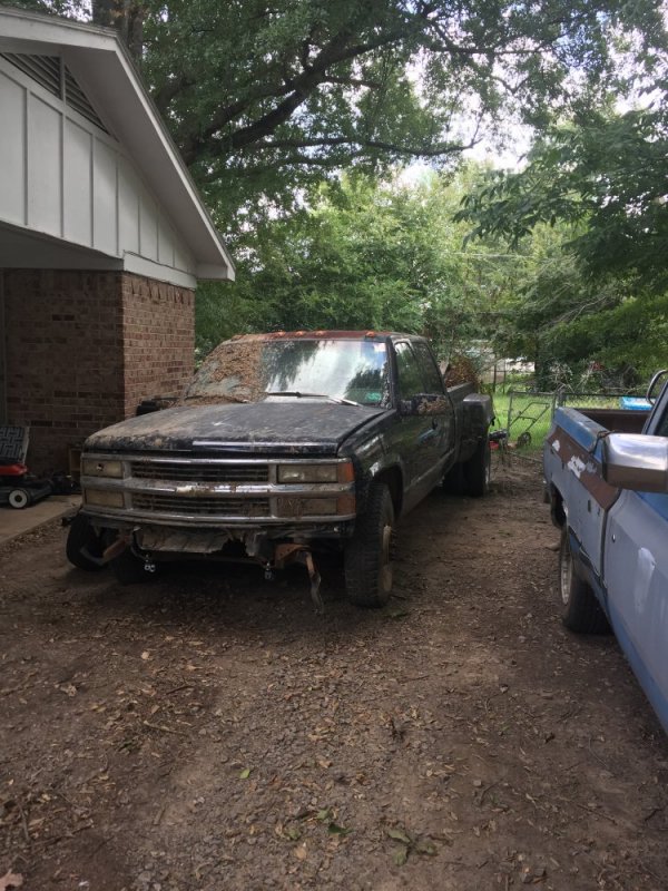

I actually think the bearings are fried in it. I’ve put 35 miles on it around my house so far and alternator outputs 14 volts until you do anything electrical it drops significantly. Also gets stupid hot after running for not very long. It’s going to become my daily next week because of my 6.2 destroying itself. :(
