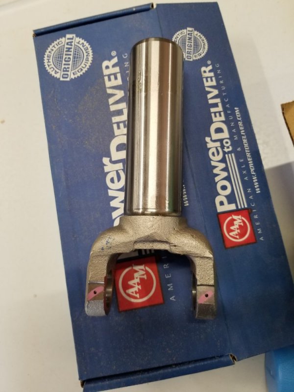

I called our local dealer to get a price on the slip yoke I need for this issue for my 2500HD Sierra - actually, mine doesn't make a noise, just feels like the drivetrain slumps off every time I go to move from a stop. I greased it years ago when I was replacing the pinion seal and I think it went away, but it wasn't really all that bad, then. Now it's worse and feels awful to drive, so I want to fix. I called the local dealership and after running my VIN, they told me the yoke I needed was 89058878, but it's only $125, my cost. Is there a chance it's not nickel plated? The rest I've seen are approaching the $300 mark for the nickel plated OEM part.
Can anyone here verify the part I need, by chance and verify it's plated?

I think I have a new one in the shop that might be what you need. I'll see what it is tomorrow

GM still sells the nickel plated and non plated yokes. The nickel plated is s TSB item. If this is a 2500hd with a 6.0l/4l80e you should have a 32 spline yoke, all 3500's, allison, & zf6 had the larger yoke in them. So make sure which one you need. That said, that number comes up as nickel plated.
