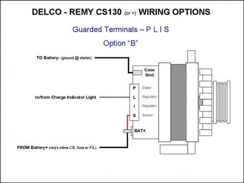

user7146_pic943_1262911052.jpg If I'm understanding you correctly, the drain only happens when you connect a pigtail to jumper the alternator? If so, that is normal. The alternator will draw 3-5 amps with it fielded and the engine not running. Another warning, DO NOT DO THIS FOR MORE THAN A MINUTE. Otherwise permanent damage can be done to the voltage regulator as cs-130 alternators require a 35 ohm resistor be installed in the field wire(it's part of the cluster if it has a charge warning light). The voltmeter has no control if it charges or not. You need to do some checks here to see whats up. You'll need a test light here to go any furthur, but they're simple checks. First make sure the large cable is receiving battery positive and in good shape(no burns in the fusible link). Next step is to check the alternator plug. You only need 1 wire if I recall correctly to make cs-130 work, and thats the trigger wire. There needs to be a 35 ohm resistor in this circuit as the regulator backfeeds current, and a direct connection will damage it. But the L terminal in your plug should have positive voltage present with the key in the run position. Insert your test light into the L terminal in the plug, and it should light up when the keys on. If it does, the circuits working, if it doesn't you'll need to find the break in the harness or check to see if the resistor in your cluster is burnt.
