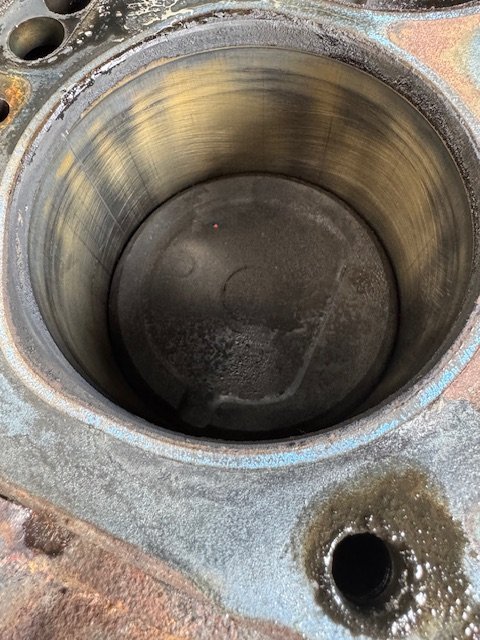

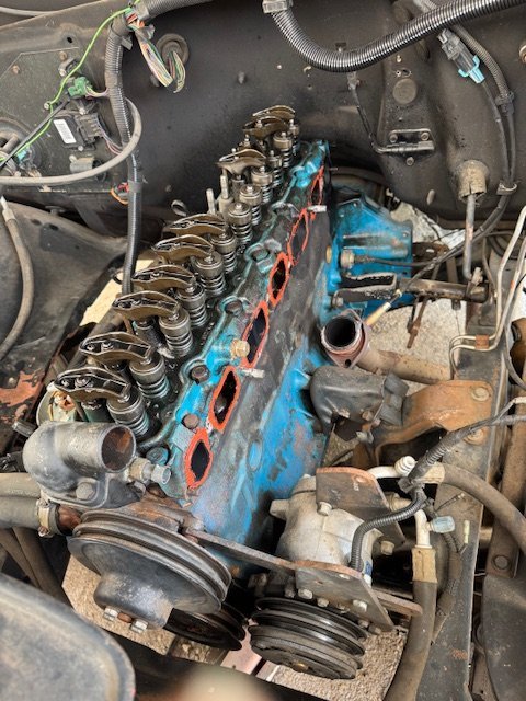

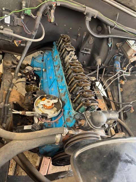

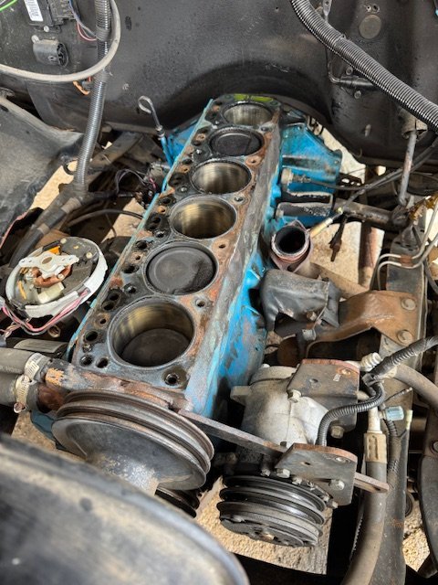

Well guys, here it is.... the teardown pics.
Intake and exhaust removed
Head it off...
#1 cylinder
#3 cylinder...
#4 cylinder... this one had zero compression

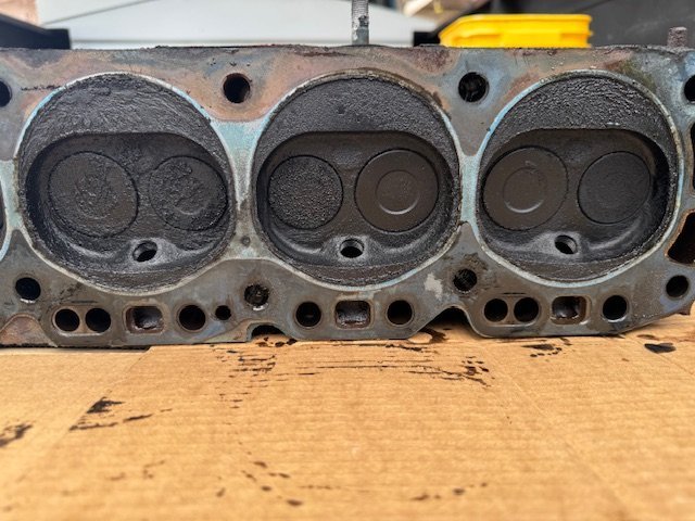

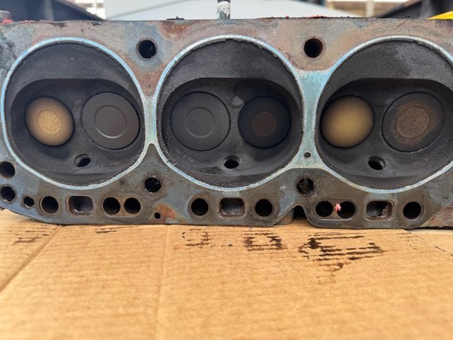

The Head... #1 on the left

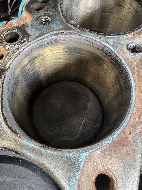

Cylinders #1-3
Cylinders #4-6
I still need to clean things up to remove the carbon deposits around the top of the cylinders and clean up the surface, but there is no visible evidence of any valves contacting the pistons. I was really worried about #4 since it showed absolutely nothing on the compression tester. #5 and 6 only had 60/70 but all three had the rockers off the intake valve and push rods. I guess #4's intake valve it perfectly sealed shut not allowing any air into the cylinder.
the head also looks crudded up on those three cylinders with #4 being the worst. there is also oil that was pooled up in the intake ports of the head too, so it needs new valve seals at a minimum.

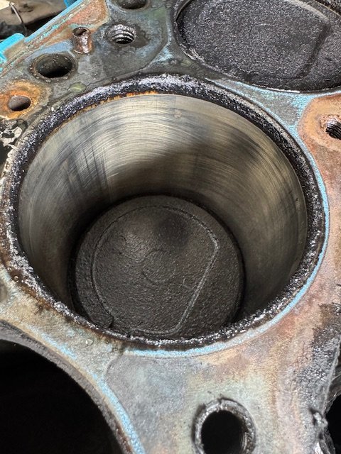

Oh yeah I did clean off on the #2 piston head to see it's markings. it's stamped .060" so this engine was bored 60 over back when it was rebuilt.

That engine looks completely wiped out.
At this point I would consider full rebuild vs replacement. Pull the block out & apart to inspect. Get pricing together to determine rebuild cost. Then get long block replacement cost for comparison.
