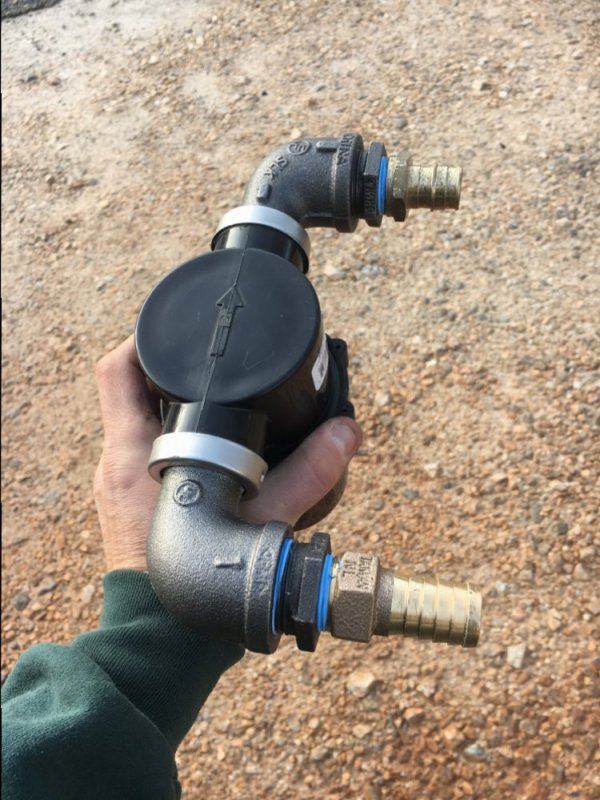

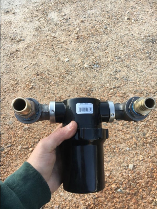

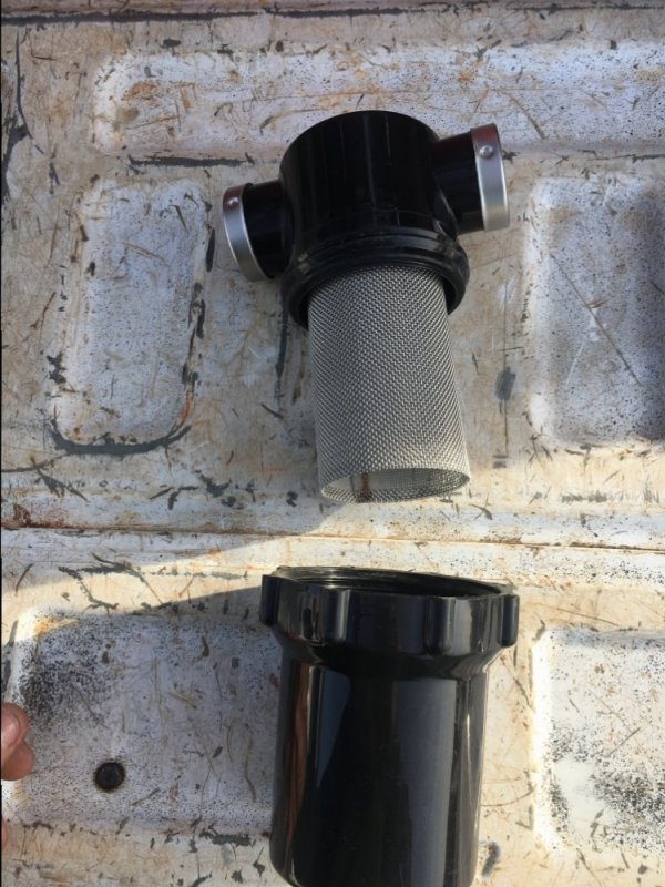

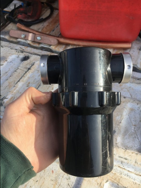

I was walking around Tractor Supply today and happened to see this strainer for a pressure washer sitting on the shelf. It’s thick plastic and has 1” npt threads entering and exiting. They have bigger ones and smaller ones but I figured the 1” would be the one to try out.
011FC733-7C3A-424A-8551-96A4136D6E74.jpeg 56E876AB-1C10-4B1E-A8BA-EA98E5B7694B.jpegEC75765C-711A-44A6-B89B-BAF1C9DF2743.jpeg 2832FF5A-8912-45D6-A6CA-6991DC77D8F8.jpeg

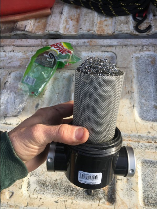

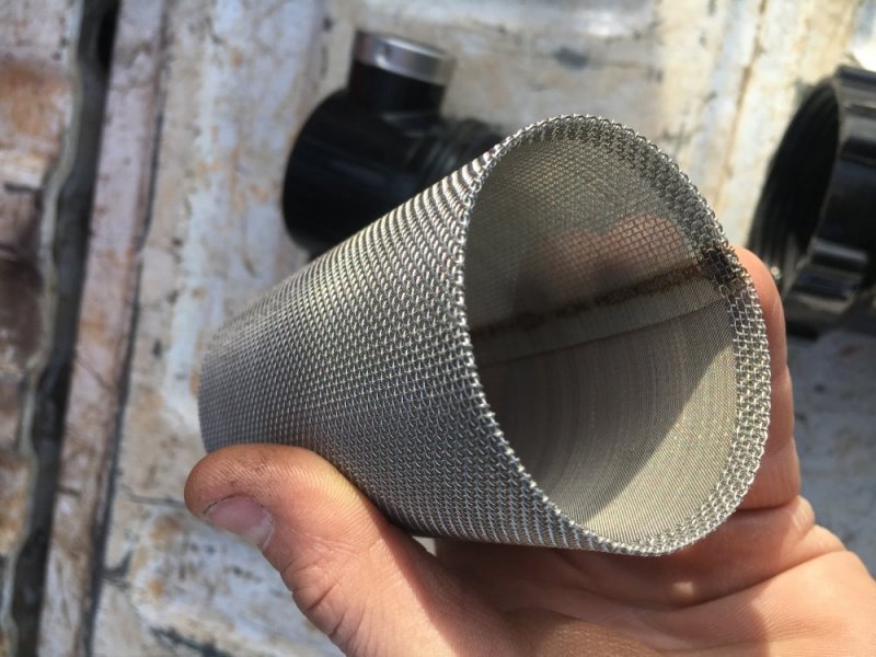

It has a course stainless screen and then a little finer screen on the inside.

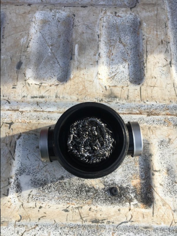

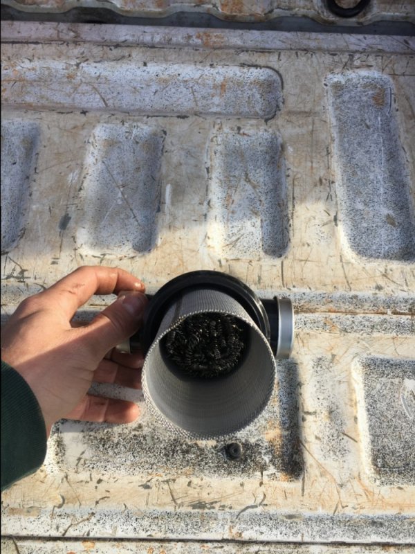

I went and got some stainless scotch brite pads and filled the whole screen full. I’m thinking that the scotch brite can slow the air down enough to get the oil to drop out and go to the bottom. 34F1969D-8BA9-4F21-8C2A-0FE479E5062A.jpeg6FF793B0-4623-4339-9E56-5BEF4D0427DB.jpeg 015F1808-6863-4CDB-B340-66DEDF66B442.jpeg49470904-0CC6-4405-AB8C-C39FA3AF2074.jpeg There is 3 balls of this stuff in there.

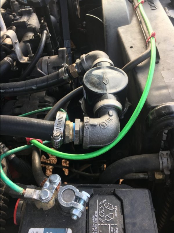

All I had on my work truck was black iron fittings so they will work until I get some brass fittings next week when I get back to work. I used a 1” st. 90*, 1” x 3/4” bushing and a brass 3/4” npt x 3/4” barb on each side. B80FC5B2-E725-419F-9189-056D6720F7F6.jpeg4E8574FC-58B2-401F-8BB0-0309B5452C6C.jpeg

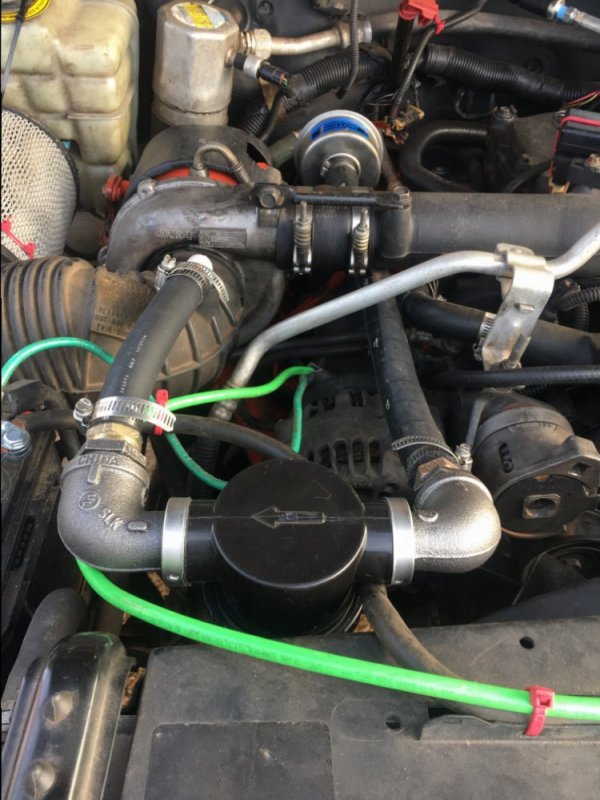

Don’t pay attention to the exposed air filter. As soon as we finish moving in our house the inner fender is going back in. I’ve also got to redo the battery cables that the P.O. put on. BDD16DB9-ADB2-4826-945B-1AE4D81D8431.jpeg5C56433B-830B-4892-8B1D-F59830DD93E3.jpeg
I’ve still got to mount it. It’s just laying on the cables right now but I’m thinking of mounting it to the fan shroud.

I’m going to change out the plastic 90* at the Turbo for a brass one when I get back to work.
I’m anxious to see if the scotch brite works to slow the air down enough to separate the oil.

The hose coming from the cdr to the catch can has braided stainless wire in it but the hose from the catch can is just heat rated hose. Hopefully it will hold up until I can get some more of the stainless braided next Tuesday.

What slows down the air is the volume of the can.
Good to know @ak diesel driver That makes sense. They have one that’s roughly 6” diameter and 1 1/2” inlet/outlet. Might have some bigger. Mine is about 4” diameter. If it don’t do what I need it to with the scotch brite pads then I will try putting some Brillo pads inside the stainless screen. I still haven’t put any miles on it to tell how it’s going to work.
