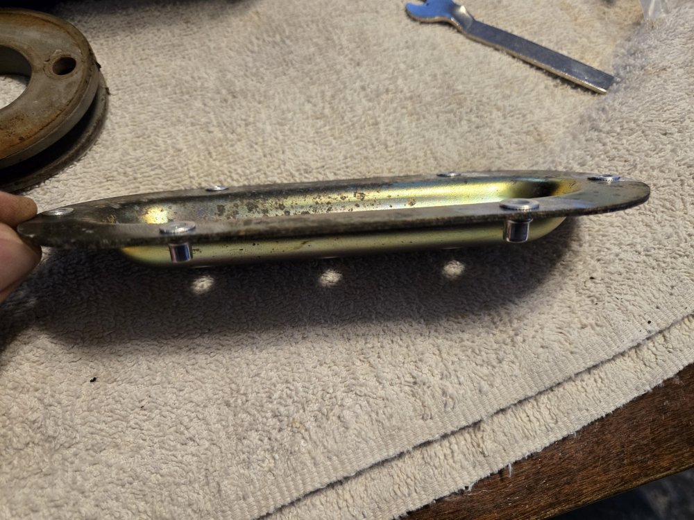

All plates are 1/16-inch thick (bottom pictured). I dont think its enough to just tap even with fine thread with how much I see these headlights wiggle.

Nutserts for the win, thanks all for the suggestions. Had to install them technically upside down, but it worked.
Had to use 8-32 under the headlight (3x) and 10-32 for the side under the turn signal (3x) due to limited clearance. Had to bend some more plastics to re-install and it was tougher with the gasket but we got it!
Just have to go get some 3/4-inch length 8-32 screws as the 1/2-inch just aren't enough.
