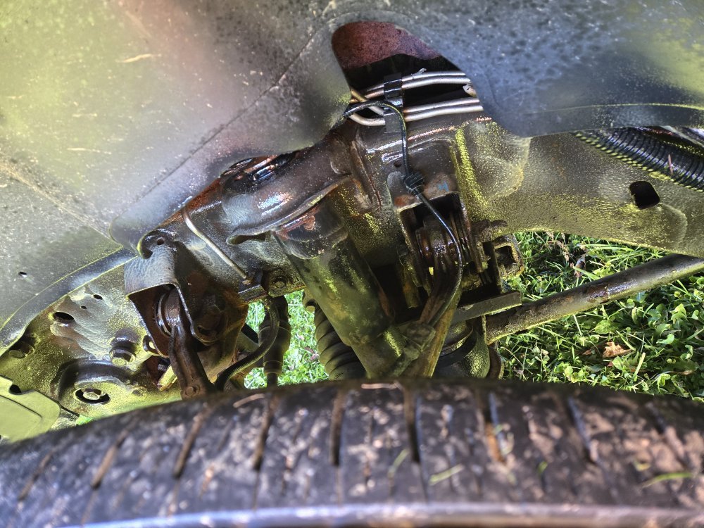

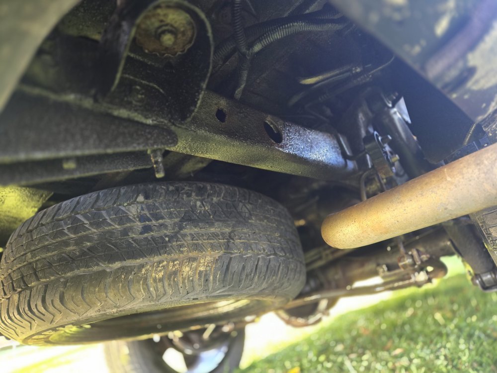

Spent some time last weekend with my annual Fluid Film undercoating. Yukon is coated and ready for its 6-month salt bath:

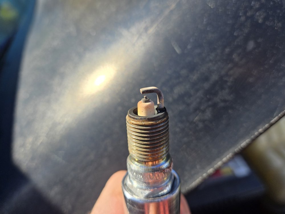

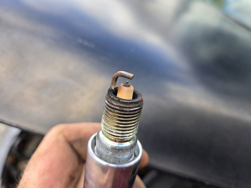

I also spent some time checking spark plugs to see if a visual identified could be seen. Even my newer scanner doesn't have cylinder balance or misfire checks. I would assume if it is misfiring the computer isn't catching it, so a scanner wouldn't. Also I am not even sure if this vintage GM has the "smarts" to provide a scanner this data. Most plugs looked good and similar to all the others:

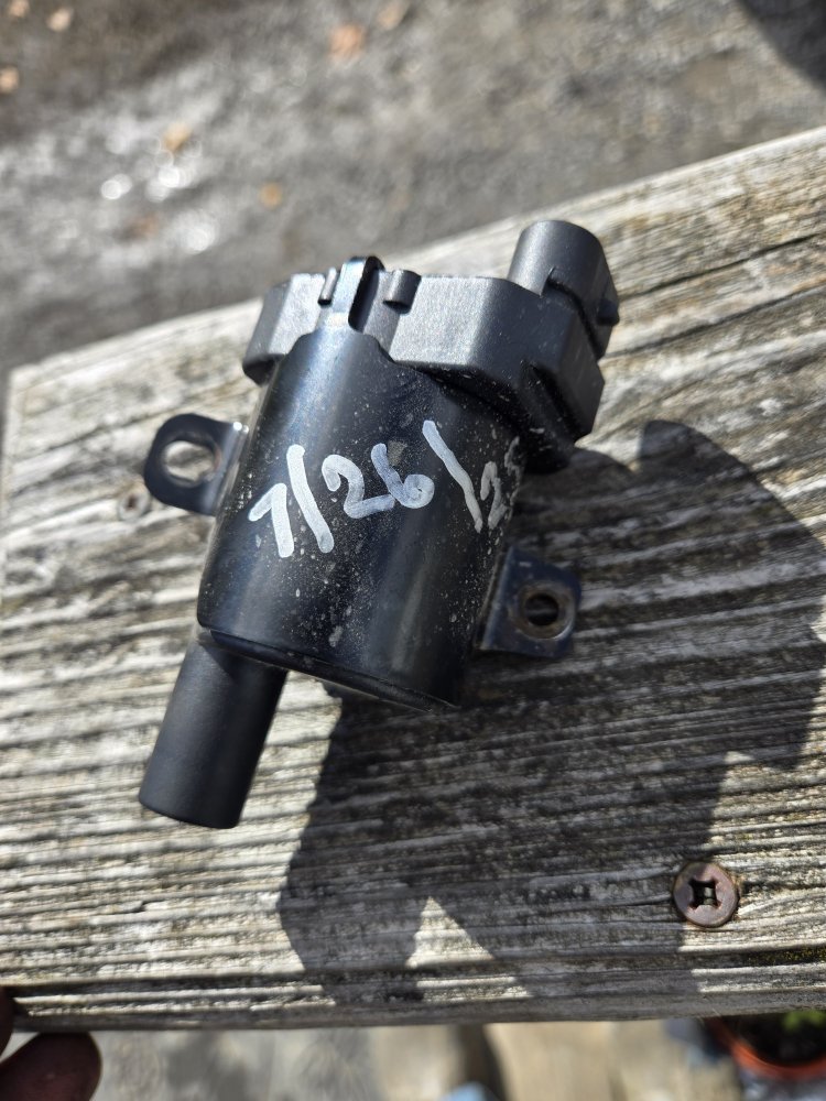

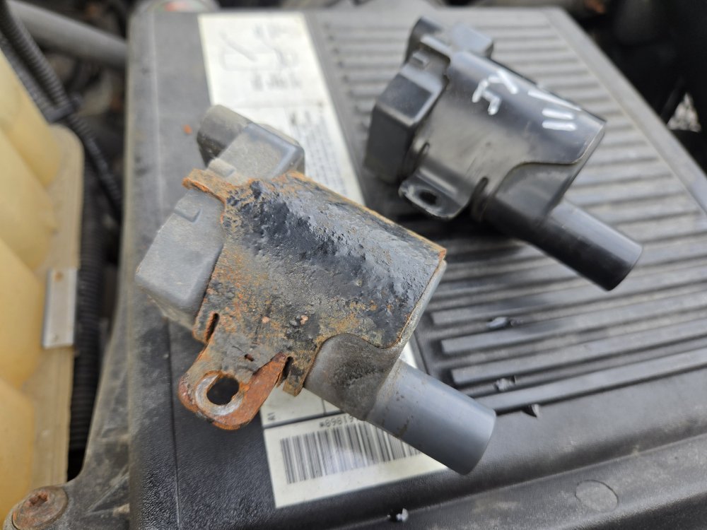

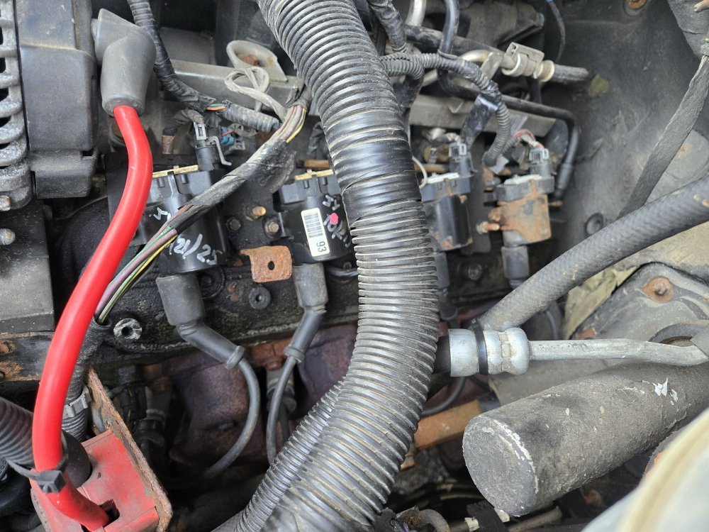

I did start pulling plug wires right off the coil while the truck was running and noticed some deviations in spark jumping from the coil across about 3/4-inches to the plug wire boot I was holding. Most of the OEM coils would arc nearly 1-inch of gap! There are some gray coils (maybe 3-4 total) that look aftermarket on there and they barely arc with any gap. I swapped what I could with my last 2 junkyard grabbed units. Visually checked arc jump again on all and I still have 2 other weak ones that I want to replace. One being the newer Napa one I got a few months back on cylinder 6. The idle felt much better, smoother.
After about 100-miles on the odometer I got a flashing CEL, and to be honest expected one of my junkyard acquired coils to be bad. However it was a totally separate coil from any I replaced prior. I need to get more coils as there are a few of the gray aftermarket, and several OEM that look very rusty (old). To date I have replaced 3 coils. I'm thinking several are slowly failing.
