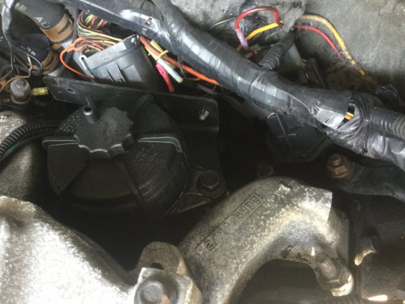

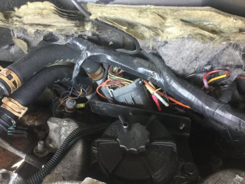

Get a picture of the rear driver's side of the engine. We need to see if the Glow Plug Controller is still there. Pull codes, yes with a paperclip, as there will be some for the glow plugs. Glow Plugs are ECM controlled on 1995 and a "tune" can change the glow times.
Okay I will get the best picture of the rear drivers side of engine in the am hours once I awake with my cup of coffee and ciggarette. =) Then I will learn what the glow plug controller even looks like this is all new to me so TY for the help Warwagon! and I love your ride BTW! Keep in mind it's a 1500 not 2500 but I got 8 lugs woo hoo! How in the world do I pull codes with a paperclip?#%? Are you serious?

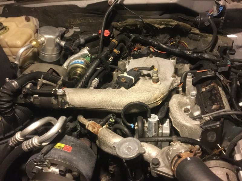

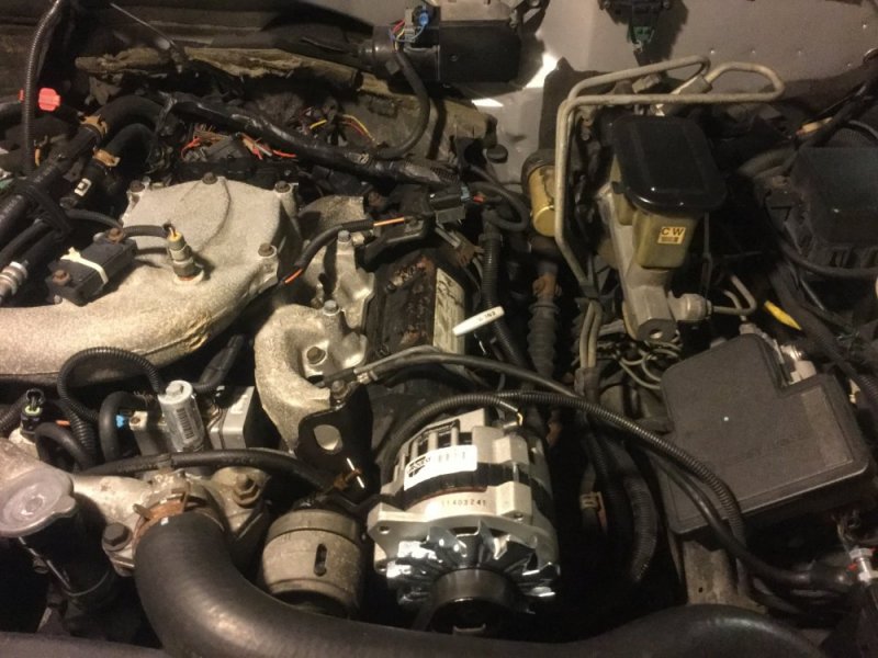

Now here are the pictures of the rear driver side engine to see if the original glow plug controller is there.
