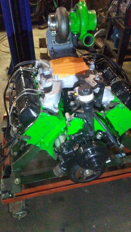

Heads are on, ARP studs torqued to 130 ft lbs with moly lube. Used high temp silicone on the block threads.
6.2 turbo
1,436
147
pa
Had it runing on the stand. Engine seems good,but inj pump leaks at the advance plug. Have the injectors set at 3500 psi. Ip is not putting out as much fuel as it should either. I think the advance is not working, prob because of the leak.

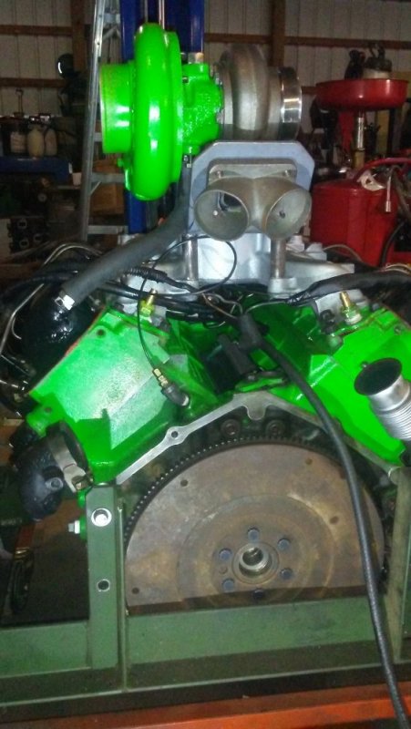

Next: HI I AM A GREEN ENGINE!! That color is perfect for this build - very much non stock! Love it.
Wow that turbo sits high! (And is green too!:happy:). That’s gonna clear a hood? Before I saw the bracket I thought it was hanging off something overhead where you painted it.
Did you make the turbo flange or have a link where you bought it please? That looks like one I am in need of.

The turbo is a bit high,but the truck has a 2 inch cowl hood. I have torqued head studs at 130 or 135 ft lbs before. At 150 ft lbs the deck starts pulling up around each stud. We used a new timing chain ,that was probably made in the 90's ,and it fit very tight. The nozzles are china 311's which I couldn't be happier with. Oil pump is the high volume one, 80 psi at idle,and 100 psi with rpms. I blocked the by pass,and deleted the cooler. This is with 30 wt breakin oil.

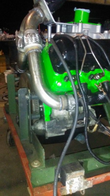

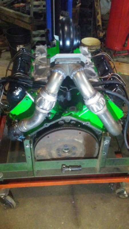

So the van/hummer exh manifolds have a 1.75” outlet. You’re going up to 2.5” then back down into the T4. I’ve been wondering about the same, or maybe only going to 2” then into the T4. Because the twin scroll t4 and turbo never hit larger size. A t4 opening is 2.04 x 3. So one side being 2x1.5= 3sq” -a touch under by space lost to divider, but so tiny, call it 3”. Then a 2” pipe has 3.14sq” so it is already slightly larger. 2.5” pipe is 4.90sq”.
So here is what I was thinking: expansion from 1.75 to 2.5 will dump heat before turbo, but also by expanding then restricting after would mess up the laminar flow.
So am I wrong - my turbo and exhaust knowledge is SO lacking...
Also, are you keeping the 2 bellows? Guess I can wait and see for that. flow sucks and they tend to crack at the band clamp. I Nickel anti seize helps during install of those to get in place better because the bind really bad being so thin. Otherwise its the pricier wire mesh type, but they flow better.
Also- is that a 14 or 16 hx40 housing? Looks like bigger, but maybe it is that mega-green standing out.

The turbo housing is .82 ar. I think it's to small. But I did install a big 10 blade turbine with 64 mm exducer. Yea I'm not real impressed with the stock bellows either. They are so thin ! I have run big and small precups ,and for me, smoke the same.
