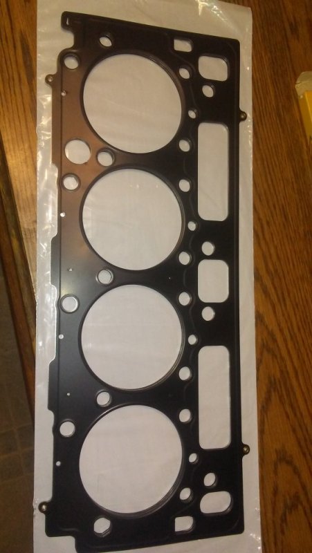

Even with a modified leaf spring I don't see a .290 pump pushing enough fuel for 400hp. Why not go with .330 pump?The stock pistons got shaved .040, getting custom Cometic gaskets. Using the smallest precups , combined with 311 nozzles @ at least 3000 psi pop pressure. And the little .290 pump,which should easily pump enough of fuel for 400 hp. Also planing on a center mount turbo.
I don’t recall if you mentioned it earlier in the thread.....what compression ratio are you shooting for?Cometic .056 thick 5View attachment 56631 layer gaskets.
