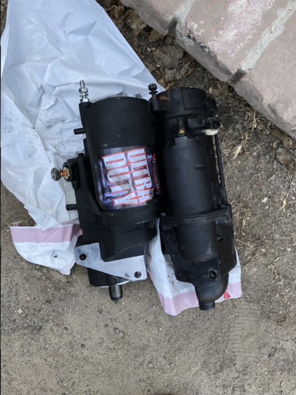

Was bored, so I took on the starter replacement job. Got the old one out. What a bitch. Had to take the bracket off the back of the starter to get clearance. That will be a bitch on the install.

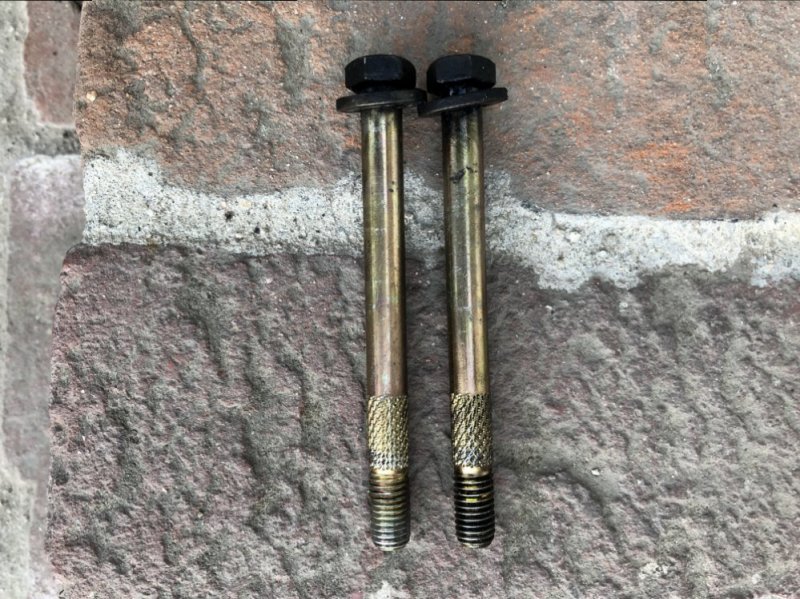

How do I tell if the bolts are stretched?
I had my wife handing me tools so I didn’t have to slide in and out from the truck.
Those look okay, what is the shiny looking fleck in the threads of the bolt on the right side ?
threads dont look stretched and distorted.

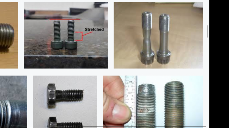

Yeah, bolts looked good. Stolen google pics below for way bad examples of stretched. Just put against a straight edge. Bolts don’t usually stretch this bad, these examples make it obvious what to look for. Also make sure the knurled area (checker board stamped area) is slightly raised above shaft height. Yours looked good there too. Kinda info for next time or next reader.
