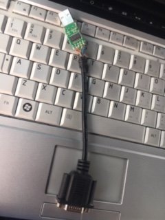

I tried to hook up my "car code computer" and get some other real world numbers but broke my serial to usb adapter. So back to key board info.....
