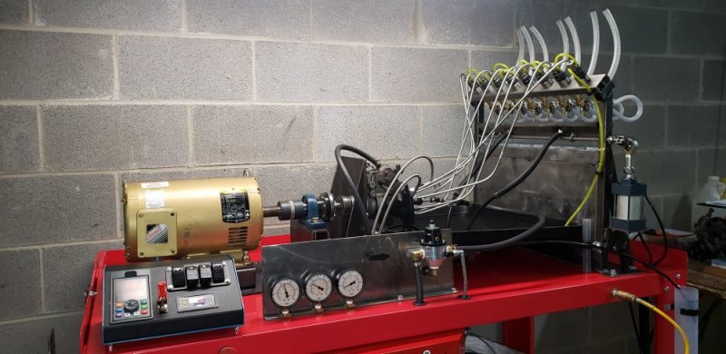

I'm looking for a known good DB2 to test on my stand to confirm my CC volume is being accurately measured. Out of all the cores I have, only one pump actually seemed to be working. But even then I'm not sure if its in normal working condition. Idle volume spec is a very tight tolerance and I want to make sure I'm setting pumps to the correct specs. Since my stand is home built using standard injectors instead of true calibration injectors I want to make sure there is no variation in fuel volume at idle speed.
My calibration bench is working flawlessly, once I have this figured out I will be one step closer to officially taking on customer work.
If anyone has a known good pump they are willing to let me borrow that would be awesome. I will pay for shipping!!
