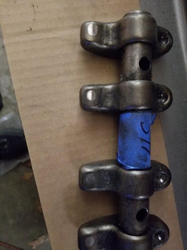

I noticed I have 2 bad lifters, So I am going to replace them all. What manufacturers do I need to avoid? I was going to send my cam to get ground down but I noticed leroy has clevite ones for $200 when the cost to grind is about $150. Thats a no brainer. My rockers are a little worn so need to replace those as well. Can I mix and match brands? Rockauto has 12 melling and 4 sealed power. Rockauto only has a cam lifter kit from Sealed power but it $600. I found these SP lifters on ebay. It says they fit 6.5 not sure though.

@Twisted Steel Performance iirc Chris has a set of new rockers off his p400 from him getting roller rockers.
and speaking of him, you might send the new cam to him for coating before install regardless of ifhe has those rocker arms still.

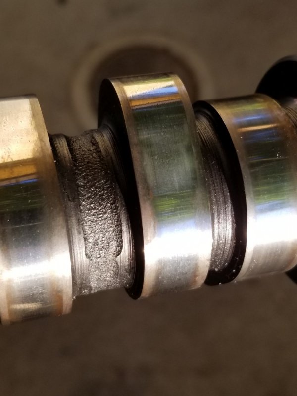

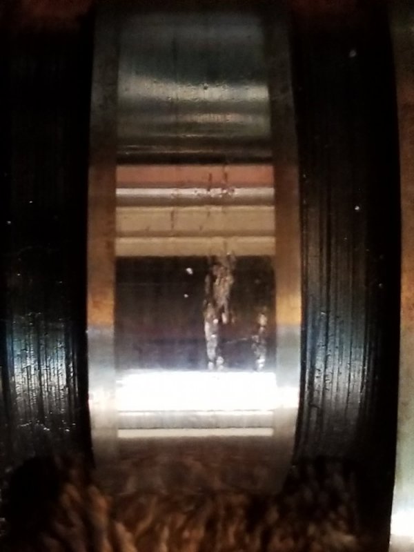

How tore up is your camshaft? pics? measurements? If it is damage then ok. otherwise if it looks ok, lobes on roller lifter engines almost never suffer height/ duration loss. I would prefer old cam getting coated to new cam left stock.

The 2 lobes in question have a little scaring still smooth I think. I will get some pics. I was also thinking the same thing about the coating. I was also thinking about asking for forgiveness. LOL

Here are the measurements. I started the opposite side of the gear. 2.173, 2.1645 - 2.1655, 2.166 - 2.141, 2.165 - 2.164, and 2.0145-2.009. The measurements with the range were measured on the shiny area and the worn area.
Husker6.5
2,444
2,500
Lincoln, NE
0.001" out of round on #'s 2&4 isn't that bad, BUT being 0.025 out on #3 and 0.0055 on #5 (using your reference from the gear, by which I think you mean the one closest to the cam gear or what would be the #1 journal. They should be measured from front of engine to back.) means you're looking at a NEW cam and bearings.

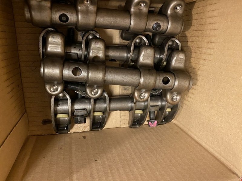

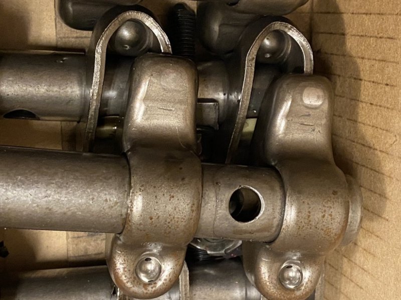

@Rodd I have a set of good rockers with what appears to be new non-yellowed rocker buttons if you want them. Just cover the ride.
