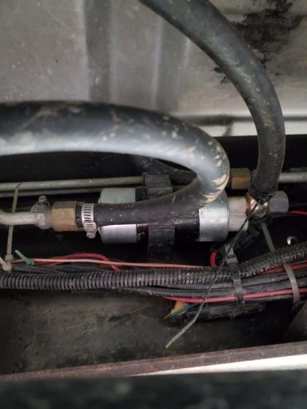

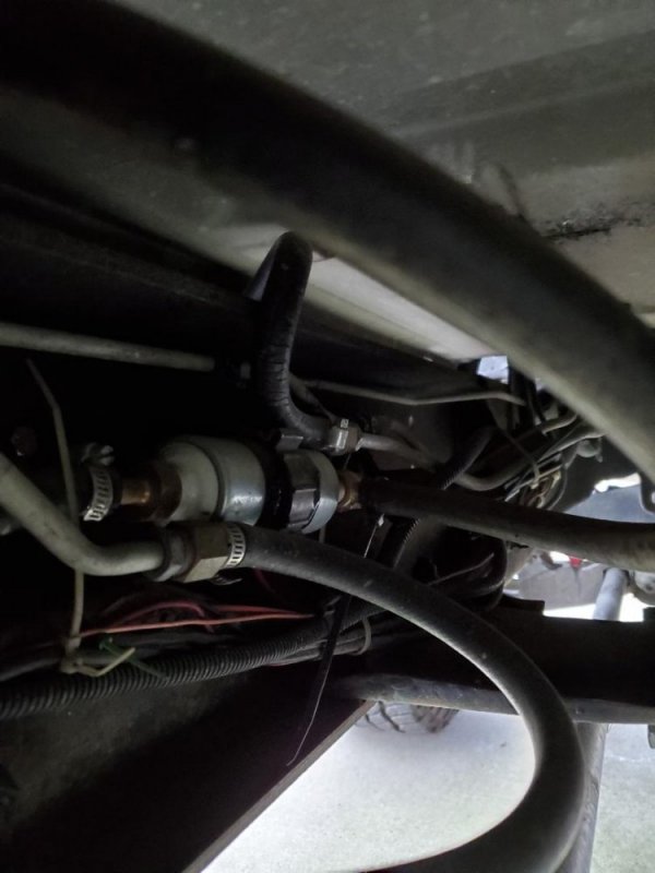

After 3 Walbro FRC-10 pumps in 5 years, I won't buy another. My problem with stock lift pumps was after doing the feed the beast mod it would pull down to a vacuum when I pulled grades with my trailer. I tried a AC delco pump for 99-00. I tried the 93 AC delco, the 93 Airtex. All of them went to a vacuum towing or even just hard acceleration. So I went to my first Walbro and it was able to keep up with demand. But the failure rate of them was really bad. So far this has been the best pump I have run pressure wise. It keeps 10 PSI all the time. So as long as it lasts longer, I'll be happy. And Delphi is saying lifetime warranty. So it shouldn't cost me anything when it does fail.

Red hit the big one with duty cycle.
Definitely would need a regulator with its own return line or electrically control the speed to produce proper pressure. Keep in mind they are saying that pressure and flow with motor oil but not specifying what grade.
IF that is from a supplier you can return it to within a year for $ back, could be worth it.
I would suggest a bypass line with one way check valve so if you are driving and it dies your engine doesn’t shut off in a dangerous situation like cross traffic that doesn’t stop or loosing power steering and power brakes on the freeway especially if tow
