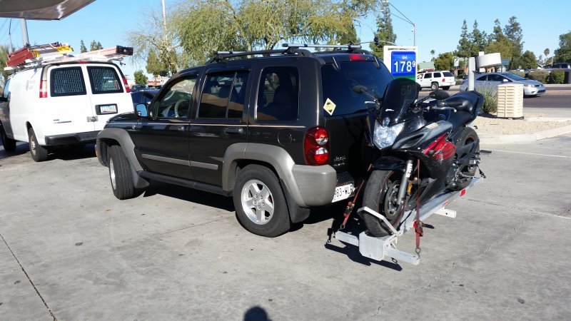

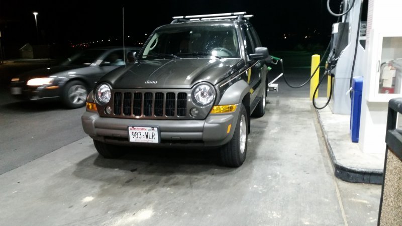

20150116_205127.jpg 20150116_143720.jpg So I purchase a new to me 2006 jeep liberty as some of you saw in my other thread ( purchasing a 2002 duramax). I figured I would move it over here where it belongs.
So far the first tank on the trip home with my wife's bike on the back got 19.47 mpg with the cruise set between 85-90 mph. I thought it would be a bit better, but still not to bad for the speed.
Today I drove it to Las Vegas and back on one tank with no bike on the back. I kept the cruise set on 65 or 70 on the back roads and 75 on the highway. This helped the little diesel net 21.31 mpg I think a few fuel economy minded mods are in the future. Here are some pics of the little rig
