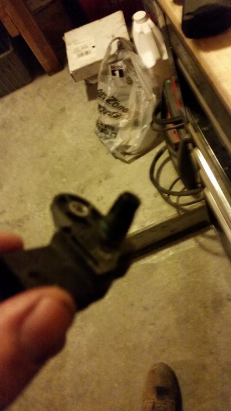

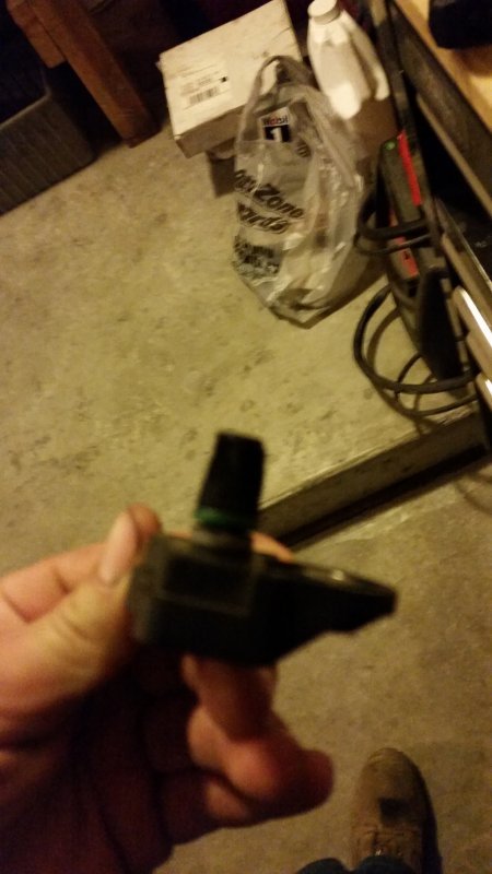

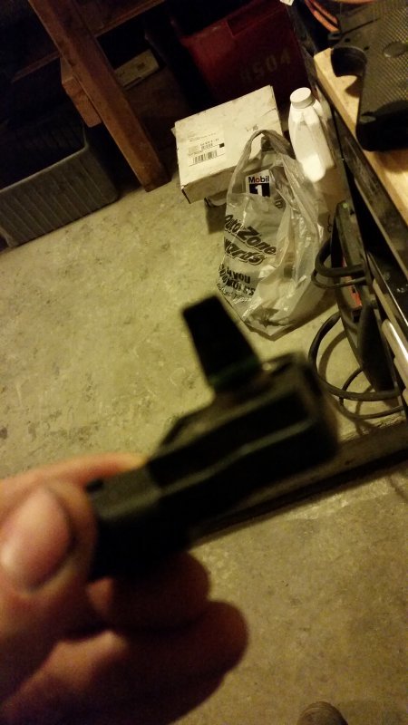

20150202_185021.jpg 20150202_185059.jpg 20150202_185105.jpg 20150202_185021.jpg Finally got around to changing the oil. I put the larger Mobil 1 m1-301 filter on that brought the total oil capacity to 7 qts. Then I replace the air filter with a new but stock stp unit, and cleaned the map sensor. Wow was it dirty. Because I am in California I have to leave the maf plugged in until after I get it smogged (I hate this state's emissions laws). Then we will see how she does on MPGs
Yep, that's how they look.
You got it cleaned up enough to actually see the sensor and no more soot on it, right?
That's correct. It looked bran new when I put it back in. I wanted to take a picture of it all cleaned up but got too excited and had it back in and driving around before I remember that I wanted the pictures. Also I set the tire pressure go the max of 44 psi they where all around 29-30 psi so that should also help the fuel economy, plus it made it ride much better.
