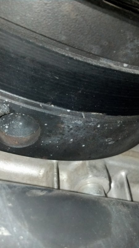

Well I Guess I'm A New Member! I'm Almost Done Putting The WaterPump In My 06 Duramax And I Was Googling For Any Helpful Hints Or Tricks When I Ended up Here. I've Watched Every You Tube Video I Could Find And Hope I Haven't Taken Any ShorT Cuts I'll Regret. It'A Been Real Hot So I've Been Trying To Work On It Early Mornings Or After Dark. I Wish I Knew The Name Of The Guy Off Youtube But He Was Very Helpful. His Video Was About 14 Min Long And He Did A Second One About Cutting The Time It Took In 1/2. The Prybar In The Flywheel Seems To Have Worked. Mine Got Stuck And Took Some Doing To Get Freed Up. Fingers Crossed That I Didn't Tweek Anything. Also The Tube That Comes Off Of The Back Of The Pump Just In Case Anyone Researching The Job In Advance"Yes There Are Two 12Mm Nuts " The One On The Inside Is A pain. I Ended Up Pulling The Boost Tube And Inner fender Off For Ease Of Access. Hopefully Someone Can Point Out A TIP For Guys In The Future . The Local Shop That I Normally Use Gets $400 For Labor And Cash Is A Little Tight So I Figured I Was Up For The Challenge. My Edge Programmer Has Been Throwing A Thermostat Code So While I Was In There I Grabbed Some O'Riellys 36$ They Were Substantially Lighter In Weight, Less Good Stuff In Them. I Figured I'd Throw That Out Ther For Some Opinions As Well? I've Got To Put The Schroud And Fan In ,Some Dexcool Bleed The System, Double Check There's No Water In The Oil And Hope She's Good! I'll Probably Change Oil Just To Be Safe. Wish Me Luck. I Loosened The Bolts And Pryed The Thermostat Housing Up Im A Little Worried That The O'Ring May Leak. I Also See Where Some guys Have Opted To Leave The Pesty Schroud Piece Out But As Hot As It Gets Around Here I'm Probably Going To Put It Back. I Like To Let It Idle On Hot Days The Way GasserS Can't Lol. If Anybody Knows It's Not Necessary Lay It On Me. That's Why I Signed Up.lol!
